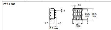

The need for a socket would probably limit some applications. The link for the socket is broken, so can't see how much height it would add, or its footprint.

Need some help, please - G-5000. Listed as 1150400 on the schematic. This is a 10-pin relay. I have an MY4-02-DC24 that says it equivalent, but it's 14 pins. Do I clip that last row of pins off?
Yes, clip them off. The last row isn't used.
