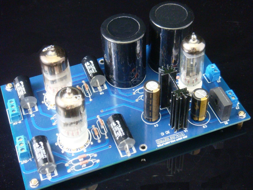

Just bought the 3 tube version from pokerelectronic last night! It should apparently be here right before christmas. That gives me just enough time to plan out an enclosure with multiple inputs. I wanna do it all within the same box with a rotary selector switch.
Has anybody done anything like this or have any ideas pertaining to this subject that hasn't already been posted in this thread? I'd love some examples/ food for thought! Pics are the best!

Just got mine in today after a 2 week wait! I have no idea how to connect the transformer, but I'm excited! I wanna wire in a fuse, a power switch, two more inputs and a rotary selection switch
After some review of this thread; it seems like mine is just a little different than everyone else's. I got the one from pokerelectronics and it came with no information whatsoever on how to connect the transformer. On one side, there are two black wires on the bottom and two blue wires coming from the top. On the other side, there are 2 blue wires and one black wire in the middle all coming out of the top.
Has anyone connected a transformer similar?
edit: figured it out! I'll post what the leads are on here in a little while because I forgot!
Also picked up a matched pair of Tung-Sol 5670 black plates with square getter, date 1957 and it brought the pre to a whole new level, not even comparable with the stock tubes. I've also since switched my speakers from Dynaco A25's to Klipsch Forte's and the stock china tubes were painful to listen to with horn midranges. With the Tung-Sol's it just sounds amazing, soo smooth. For less than $100 total investment for a preamp this thing is so worth it. Next is some k40y-9 PIO caps. Still haven't made a case...

One thing I've learned with this preamp is how badly it needs a large volume knob. The small knob that comes attached is way too difficult to adjust accurately. Since I couldn't remove it for fear I'd break the control I fashioned a large knob that fits over it. Not ideal.
Has anyone been able to remove the stock knob?
Rat Shack has some very nice silver knobs that would work great if the stock knob can be removed.
