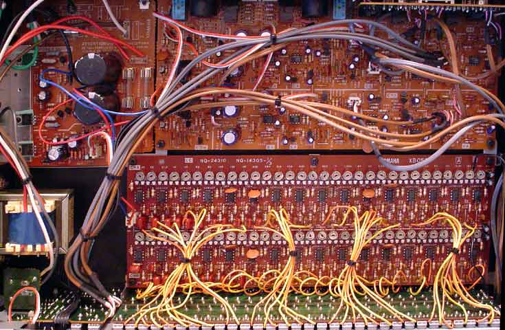

Selecting Replacement Capacitors
Plan "c"

Granted - a quick read by me, but here's my take on it. Voltage isn't all that important - maybe once, but the forming process that was once a big bugaboo is no longer an issue. The caps are formed in the factory at much higher voltages than the real world will ever throw at them and should stay stable over a broad range.
With that - common sense would dictate one uses as close to the original rated voltage as is available. With that in mind, sticking with "audio grade" capacitors designed for signal path applications <should> be better than substitution of general purpose caps of the rated voltage value.
So there. I think. <G>
That doesn't cover the point that the manufacturers can play voltages close to the vest to keep costs down. It does address the fact that out of spec voltages can cause oscillations and other not so good nastiness depending on the application.
PLAN C
- Elna Silmic II where available (any voltage)
- WIMA poly where they'll fit OR Nichicon KW when all else fails
Bypass caps strictly Polypropylene, either .047 or .1 depending on availability. The Panasonic ECQ come highly recommended for bypass caps, but come to find out those are polyester? Still a bit confuzed there.
So ... any closer to right?

OK then ... Plan "B" ... v2
Had these suggested to me.
Panasonic ECQ-V - .047µf - Polyester Stacked Metalized Film
And right behind that ... Why bypass?
Once again, I <hear> it tends to smooth transients and add presence. Which may (or may not) any longer be true what with upgrading to audio grade electrolytics and improvements in the quality of what you can get now as compared to what was available back in the day.

Hi, I've ben a voyeur on this thread 'till now. I have this to add.
sKiZo, it's quite likely that you're over-thinking the issues. Just buy some caps and put 'em in. Just make sure that:
1) the new caps are rated at a higher voltage than the old ones AND
2) that they will fit in the allotted space.

Just go for Elna Silmic, Nichicon when elna are not available, and Panasonic FM in large power supply caps, or just the Elnas. It will be OK anyway.
Elnas are quite big, bigger than older caps in many cases, so check the size before.
Regarding the by-passes, I-ve read that 1/1000 of the main value is a good starting point to by-pass large electrolytics.
I'm not an expert, but I guess a 0.1uF by-pass in a 2500 uF cap won't do any difference... I've added 2.2 to my 1000 uF

Yes - I am overthinking things here, but I'm like that ... somebody shoots me, please!! <G>
I did place an order for Elna Silmics last night. Between Parts Connection and Handmade, I was able to get good matches on most of what I need. Couple exceptions, but apparently the stereo gods aren't into making it TOO easy. I may have to get creative with a couple of the off the wall values.
BYPASS CAPS - There, the internal debate rages on. Do I even need them with new quality caps installed? Once again, with all the fun this thing's gonna be, I want it to smoke ... er ... strike that ... scream! It's looking like the Panasonic ECQ-v stacked metalized polyester gumdrop may be the best candidates. Which leaves size.
I'm familiar with the 1/1000 rule, but ... I also see yet another "rule of thumb" that says it isn't all that critical in the signal path and that you can usually get good results with either .047µf OR .1µf ... so ... which one? There again, I <hear> that depends on what you're going for. If you're looking to tighten the bottom end, go with the .1µf ... if you're looking to smooth the high midrange and add presence (opening up the soundstage), use the .047µf. In this case, I'd then go with the .047µf as bass isn't an issue, and the 9001 seemed a bit shrill on the top compared to what I like to hear. I'd also planned to concentrate on the .47µf thru 4.7µf as I'm told that's the critical range in the signal path. Please don't quote me on any of this, but DO chime in if there's any truth to it.

+2. What ever way you go, what you put in will be better then what is in there now and 90% (at least) probability they are better then the parts were when they were new.
It looks like you are letting the best become the enemy of the good. You could end up stressing over this so long that it never gets done.
It will sound great as long as the capacitance is right, the parts are installed correctly and the replacement part is rated at or over the original. Keep in mind - you work is making things better.

OK ... uncle! I'm thinking it would be best at this point to let the debate rage on, forget the bypass caps, and just go with the original design. When all else fails, go with what a dedicated group of professionals tasked with creating a TOTL receiver came up with.
Well ... maybe just the tone boards ... :cool:
** Speaking of tests ... I do happen to have an 8080DB sitting on the shelf. Basically the same design as the 9001, minus a couple channels. Same tone boards and amp. It's even got the problematic pass through connections on one of the boards. I really should experiment with that one first. Except for the fact that it's easily as complex as the 9001 and just one of these may have me bouncing off rubber walls ... <G>:nutz:

Some interesting reading ... a few of the highlights:
BYPASSING
Bypassing is used to reduce the noise current on power supply lines.
Bypassing reduces the rate of change of the current through the inductor.
Bypassing provides a secondary high frequency path that shares as little inductance with the primary path as possible.
More is better - better to use many small caps than one large one. The result is much lower inductance.
Just tends to reinforce a lot of what I've heard about how bypassing can help smooth a lot of the transients that can bleed into the listening environment.

For the 3.3uf caps in the signal path someone mentioned Wima, but if you want you can go a step further and add a couple of 3.3uF 250Vdc Claritycap ESA Range polypropylene in some key positions, only 23mm x 28mm.
A whole bunch of steps forward - not sure which is more impressive ... the specs or the price! $9.33 x29 ... that's, er ... a LOT! Almost what I've got into the whole project already.

Which leaves me leaning towards relatively good audio grade caps for ALL! The Elna Silmic IIs fall into that category for the values available. Best bang for the buck all across the board(s).
