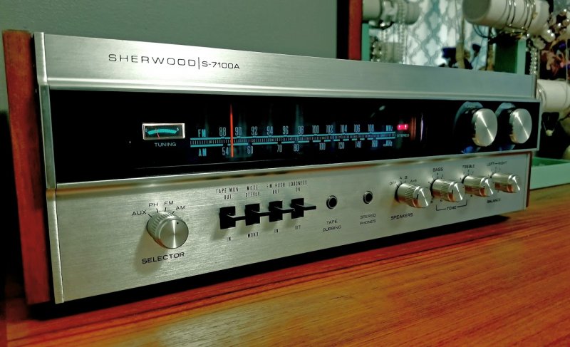

While I had my Sherwood S-7100A opened up for some other maintenance, I thought I'd look into why the illumination of the scale looks so dull and lifeless. Here's what I found:
As you can see, there is quite a bit of carbon build up inside the fuse lamps. Not a big deal. They are standard 8V, 0.3A fuse lamps. I think I may even have a couple on hand. That would explain the lack of brightness compared to other vintage receivers I have re-lamped.
The second issue is the blue plastic filters that fit between the lamps and the ends of the dial scale have completely burned through over time.
I actually don't think these blue filters were designed to create blue illumination. I think they were originally intended to remove the strong yellow cast of the incandescent fuse bulbs. Yellow and blue are complementary colors and in photography a strong blue filter (Wratten 80A) is often used over a lens to correct for proper white balance when shooting under incandescent illumination.
It looks like I have some choices. The obvious choice would be to replace the original lamps with some new 8V .3A incandescent fuse lamps, but that would also require replacing the damaged blue filter pieces. Can anyone recommend a source for replacements? Maybe get a Wratten 80A filter and make my own.
The other option is to replace the original incandescent fuse lamps with some LED lamps. These come in warm white, blue and even turquoise. I've seen photos using blue LEDs, and I don't think that's what I want. They look too blue, and as I said above, I don't think the original blue filters were intended to create a blue light, just to cancel out the strong yellow cast of the incandescent lamps.
Turquoise LEDs are interesting, because as you can see i the second photo, the original scale has a turquoise color. Has anyone tried Turquoise LEDs in a vintage receiver? If so, how did you like the results (please feel free to share a photo or two).
The final option would be the warm white LED lamps with no blue filter. Has anyone tried this? Again, photos and opinions are welcome.

Thanks for the suggestions. I'm not sure if you can tell from the photos, but the blue filters are bent and a 90-degree angle and the two sides are asymmetrical. They are quite brittle, especially around the area that burnt through. I have some incandescent lamps on hand (7V, 0.3A instead of the original 8V, 0.3A) so I may as well give it a try. I have a heat gun. Maybe I'll warn up the plastic a little before I try to re-bend them.

That worked reasonably well. Replacing the old lamps brightened things up and flipping the blue filters give the scale a nice baby blue color. Rather than try to re-bend, and risk breaking, the thin plastic blue filters, I simply trimmed the long side to be the same width as the shirt side.

Those 7V bulbs will run hotter than 8V. They will likely die an early death. Get the proper ones!
This is probably the correct one. Check the data sheet....
http://www.mouser.com/ProductDetail/JKL-Components/GF680
Understood. I just happened to have a bunch of the 7V 0.3A fuse lamps on hand. I bought a lot of 24 of them on eBay about 4 or 5 years ago. By buying in bulk, I got them for less than a buck each, including free shipping. I'll order some of the 8V lamps and swap them in for the 7V lamps when they get here.

I put warm white LEDs in mine.
The blue films were nearly completely burnt up, and I have not replaced them.
I get a light green color on the dial numbers, as you might guess from the blue numbering and the yellowish output of the lamps.
Your tuning meter is close to the color I see on the dial.
My camera is hosed at the moment, so I cannot post a picture. Sorry.
It looks pretty good actually, but it is not original.
After seeing yours I may improvise replacements one day soon.
