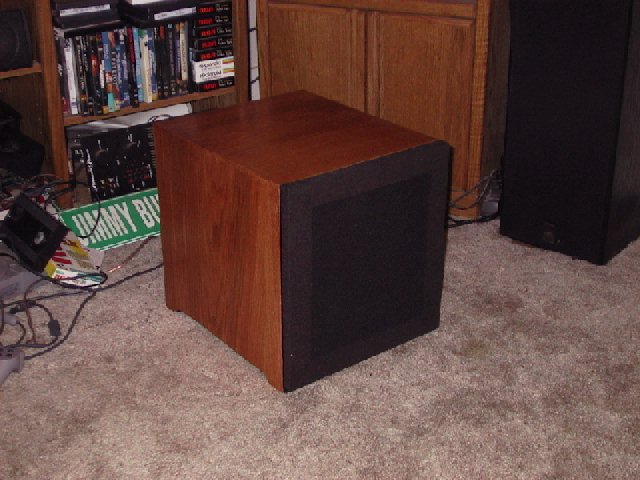

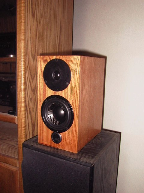

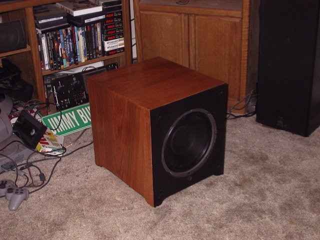

Here's a sub I did for a friend. It's a 10" from Martin Sound (2601, don't know if it's still available or not) powered by a PE 100W plate. Sounded pretty good with the sats which are the Adire Pop! I wanted to check out Dan's design and a friend wanted some speakers so it worked out well. The difference in wood look is my crappy photography, they're the same sheet of veneer with the same stain and finish. I also learned to paint the grill frame black before putting the cloth on as it shows in flash photos. (side note to Specialidiot: these went to Dr. Janet in SLC)
With grill:
Without grill:
Satellites:
Ray
