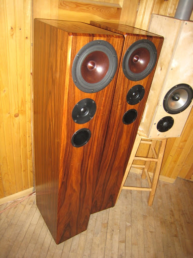

There are many very well done speakers in this thread, some like from proffessionals. I envy :).
Recently I was „forced“ to make a speakers to the living room. I choose floorstand design and 2-way setup. Woofer is vifa XT18WH09-08, tweeter vifa D27TG-35-06, crossover net is done by the guy who has done it for my previous set too. Cool thing with him is that he provides the opportunity to listen and tune the setup, before it is considered as done. It was especially useful with my previous Al+ceramic set.
Cabinet is made of 21mm baltic birch plywood, lower part of it is filled with sand. Veneer is rosewood with shellac and wax finish.
It was my first veneering and there are some details I am not totally satisfied with, also couple things I'll make another way next time. But all in all I am quite happy.
More pics in my album
On pics you can also see my previous, still unfinished project. Cabinets are just experimental, I hope that someday I am able to make new ones to suit my listening room. But there's an amplifier restoring/recapping in queue before that.
... and most challenging part in veneering was a woofer cone ...

Ramli, you have nothing to be ashamed of with your speakers. They are stunning!

ramli- excellent attention to detail on your cabinet work!! I bet they sound every bit as good as they look as well- reading these posts and seeing this level of work always inspires me on to the next project.
