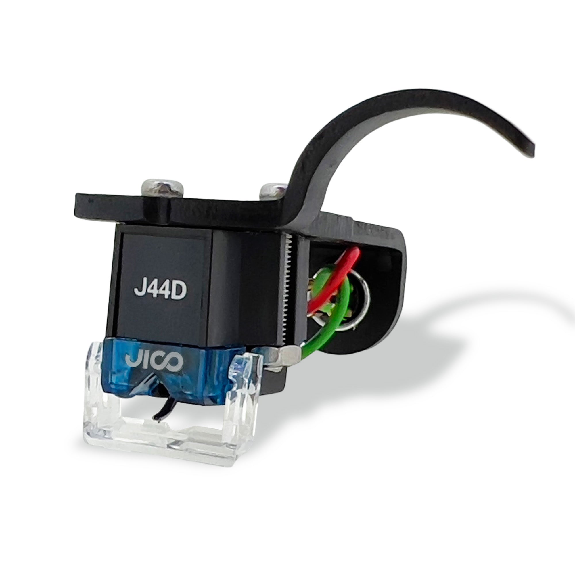

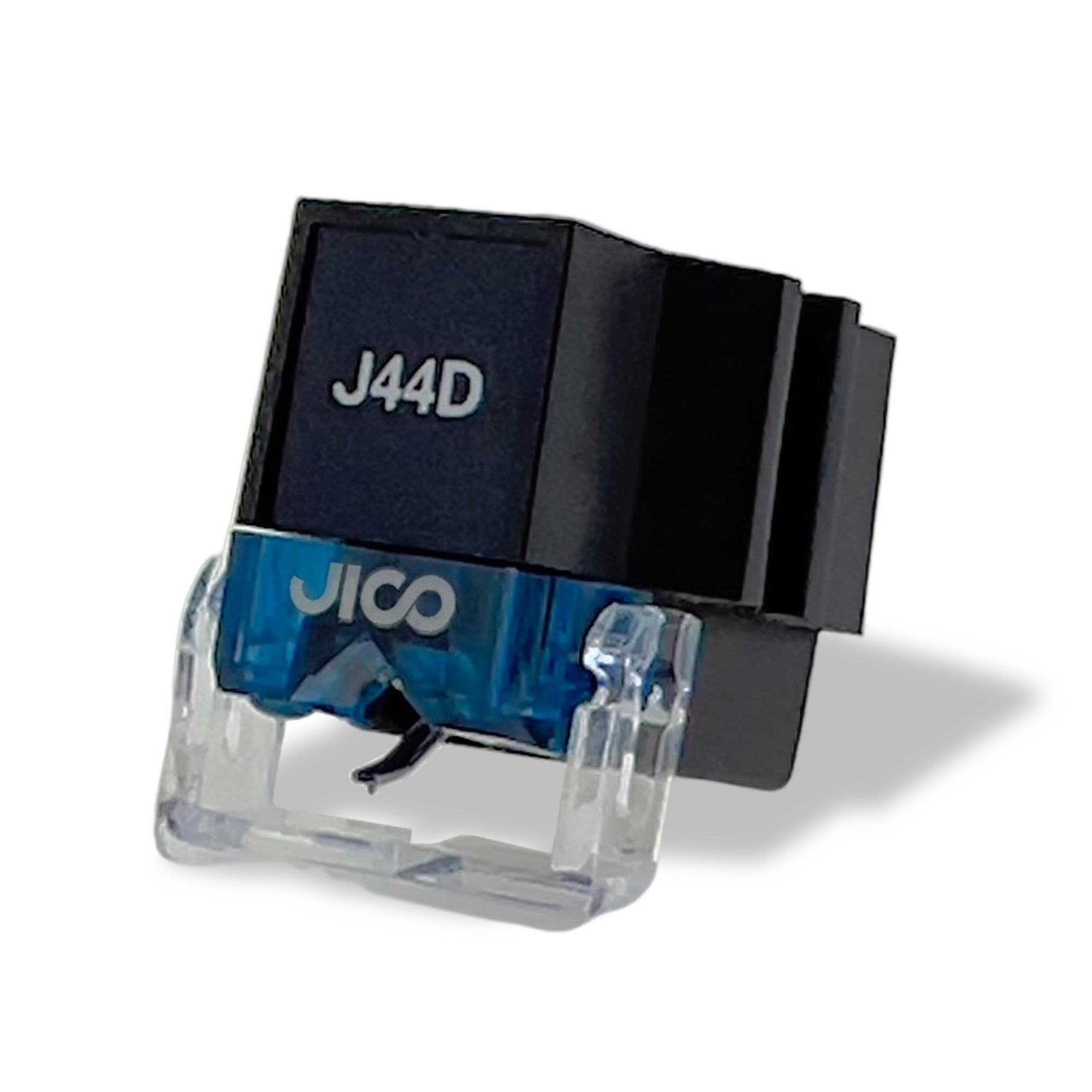

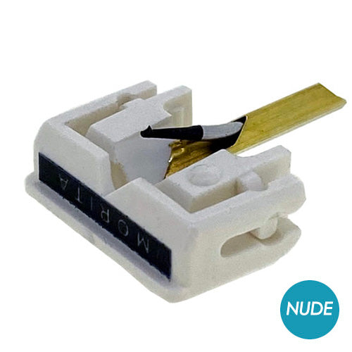

This would be my first choice for a budget cartridge, especially for the SL-1200. The nice thing is, there are several styli that you can purchase later to upgrade the cartridge body when funds become available

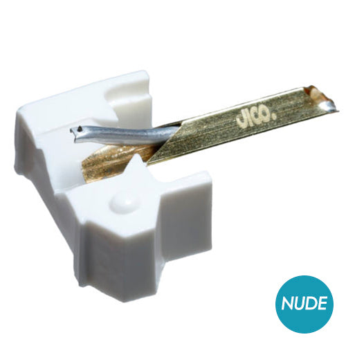

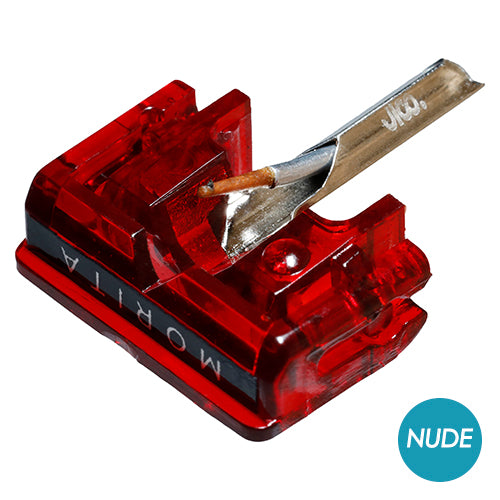

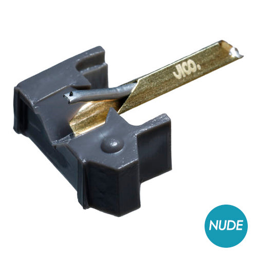

...Stylus Upgrade Path...
"nude" medium compliance...
"nude" high compliance...
higher-end styli...

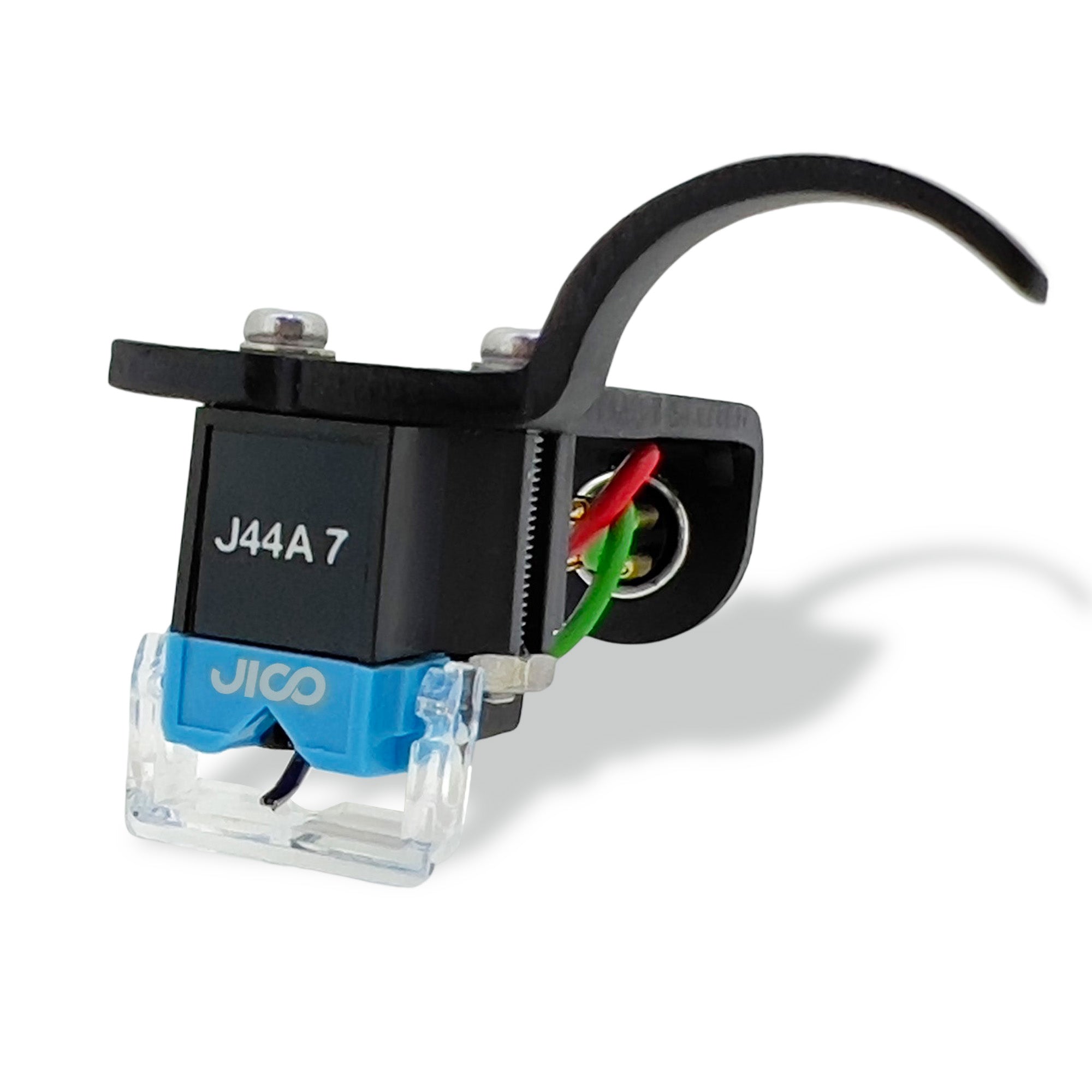

Also, I forgot to mention, it doesn't come with a cart headshell, is that something I can simply get cheap or should I consider that as well?
alright thx for the links. I will look into this. :thumbsup:

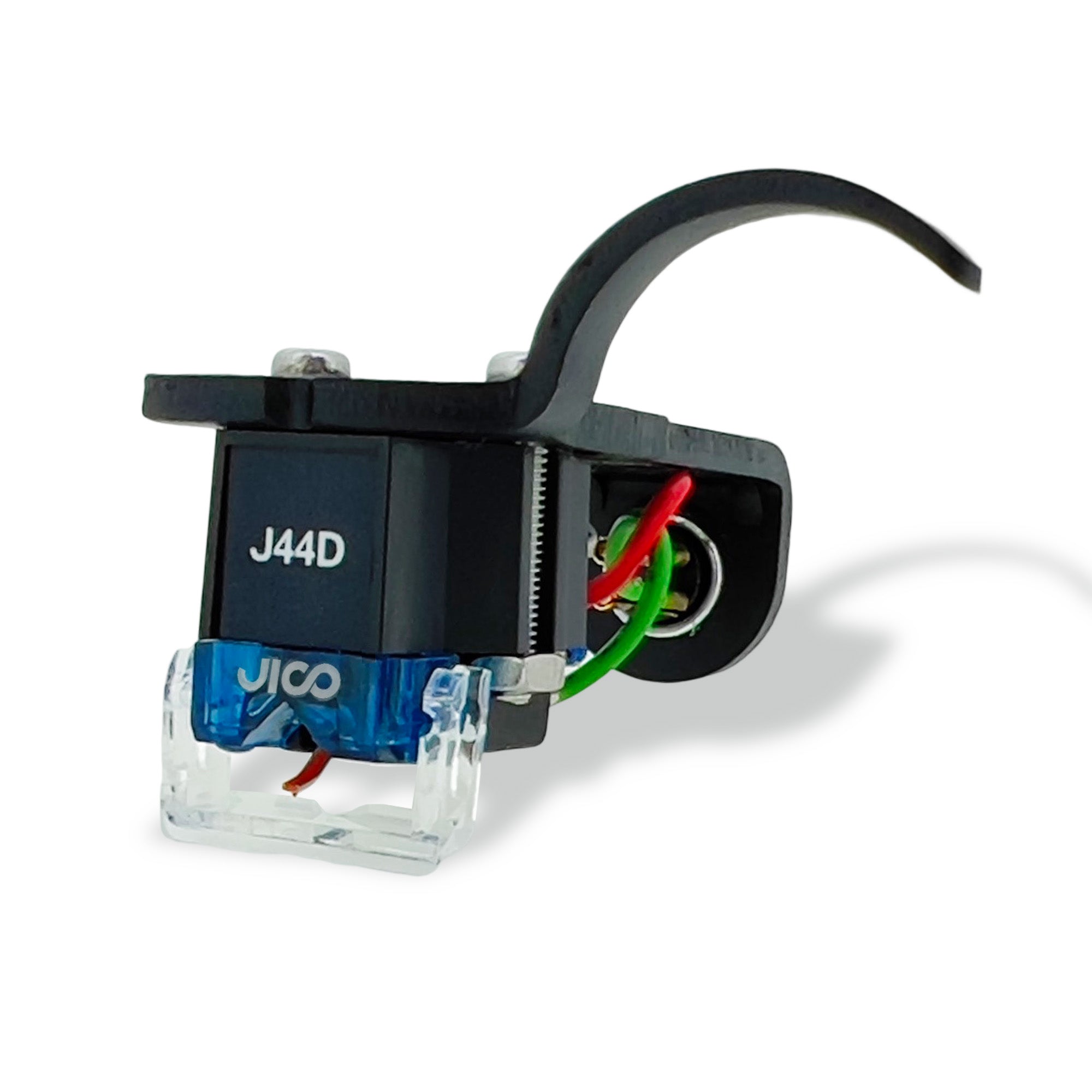

the cartridge/head-shell combination I linked previously is a "DJ" version which tracks between 3.5 & 4.5 grams. That's too high for home audio use.
This is what I meant to recommend. It tracks between 1.5 and 3.0 grams which is better suited to the SL-1200.
If your SL-1200 is in excellent condition and has not seen hard use by a DJ, you could use a more sensitive stylus in your tonearm.
This one tracks between .75 and 1.5 grams

I'm not sure about that yet. The seller said it sat for a couple of years as a backup turntable for DJs, so I don't know if it's been used heavily. I know it will surely have a lot of age on it, so that cart might not be for me.
then this would be a better match...
