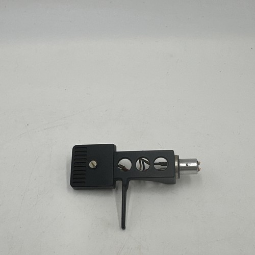

I suspect that Ortofon Concorde II was suggested merely because you don't have a headshell.
If you really are an "audiophile", you'll look into something that does not limit your possibilities.
Original Technics head-shells are easy to come by, there are many on the used market and are better quality than things like the one you just bought which is going to be heavier and harder to set-up than the original.
An original head-shell will allow you to experiment with cartridges as you gain more experience.
If you like Ortofon, look into the OM series. The OM 5S is the entry level and will be a better option for an audiophile

At the start of the thread, you recommended products by JICO. While browsing their website, I noticed they had styli that came with a head shell, so that you could swap it out if need be. If the Concorde isn’t a good option for someone like me, do you think that this would better suit my needs?
Yes, that is a very good cartridge and head-shell combination. It will allow you to upgrade the stylus at a later date, or if you are happy with the original, simply buy another stylus when it wears out.
Since you bought a used turntable without a head-shell or cartridge, you have the option to either buy a cartridge/headshell combination as I suggested or to buy a used original Technics head-shell on ebay and new cartridge to learn how to install a cartridge in a head-shell and align it properly. This could be a more affordable way to go and at the same time you would learn what any audiophile should know.
Because the JICO headshell/stylus combo costs 180 dollars and this is my second time doing this, I think I will take your advice and buy a used Technics headshell and then get an entry-level Otrofon cart (or whatever cart I find to suit my budget and needs) Before I get any of that though, I will return the cheap cart/headshell.
So I will chime in since I have a SL-1210 MKII that I have upgraded over time. From my experience KAB Electro Acoustics is one of the best sources for anything to do with the Technics SL-1200 and it's variants.
I purchased a Technics original headshell from KAB which makes me happy to know it is an true Technics headshell and not a copy. Other parts such as bulbs, turntable interconnects, tone arms, etc. have also been sourced from KAB.

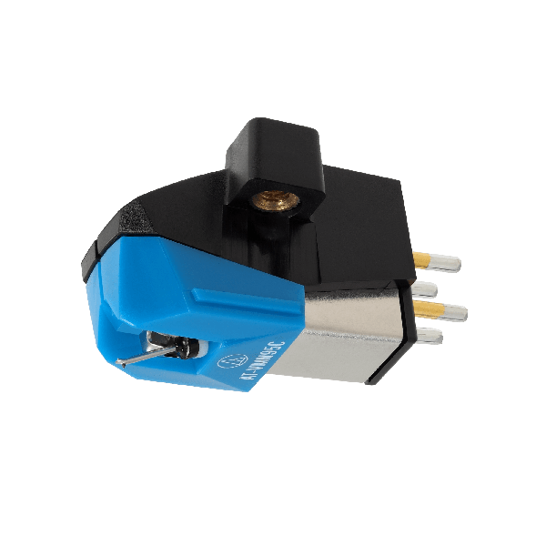

For cartridges I would currently recommend the Audio Technica AT-VM95E as a starter cartridge, good specifications from a reliable company.

the Audio Technica cartridge @Dony suggested is another good option, it too can be upgraded by simply buying a new stylus of which there are several flavors.
I personally would start with the AT-VM95C (conical) which is only $39.00 and can be upgraded later with a elliptical stylus.
