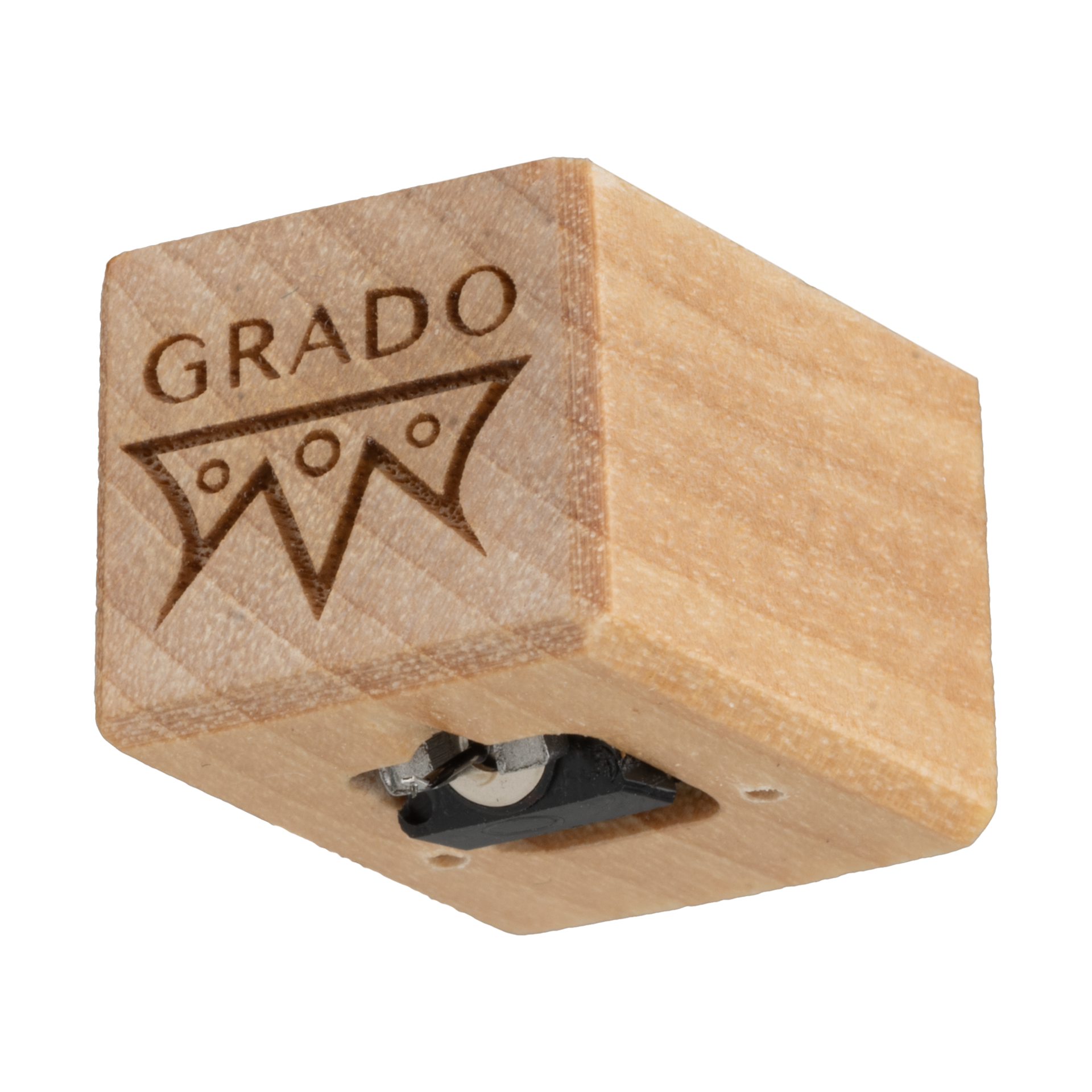

The Grado Opus 3 is a massive bargain, few carts have close to the separation or soundstange.

Looks interesting but which "few" ?

I see a lot of carts in my business and few if any have such big separation. Many claim 30dB plus but not many manage it. The Opus on the other hand usually exceed the separation specs by quite a margin. I have measured Opus 3 with 38dB separation which is not just good, it is stunning.
