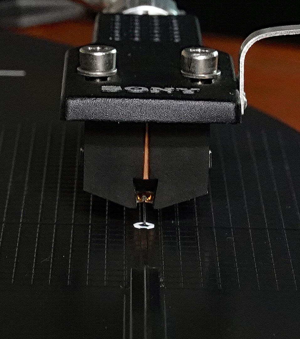

i know there are a few threads pertaining to similar situations, of which i have read many, but this particular replacement stylus is brand new whereas most ive seen mentioned in these threads were purchased used. ive aligned the cart relative to the cantilever as opposed to the cart body and everything sounds right. i contacted LP Tunes with this same image asking if a cantilever with this amount of skew is "within tolerance" or if this unit is eligible for replacement. they want me to send it back and wont comment on the photo, which i suppose i understand from a business perspective. so firstly, i wanted to get your opinions as to whether or not i should just leave it aligned to the cantilever and run it like this, or if it would be worth sending back for them to check out.

First of all, the cantilever doesn't look that bad to me. It may even correct itself when antiskate is applied. More critical is channel balance, but if it sounds good, it is good.
On the 2nd matter, output varies with magnet strength. I seriously doubt it has anything to do with effective mass. The noise floor seems lower because the overall output is lower. I don't see this as an issue.

I think I see the skew you are referring to. I am used to looking at a picture from the bottom instead of the front, so it is hard for me to compare it to cantilever problems I have experienced. With a new stylus, one never knows what is going to happen. Conceivably a new stylus might have a different output, than an old one, especially when the spec's of the stylus are different.
The magnet is a part of the needle, so when you changed the needle you also changed the magnet.
The wood shell is better damped than a metal one and so may seem to be quieter than a metal one. An analogy would be a wood horn vs a metal one, the metal one will seem louder owing to the properties of the metal. Only way to know for certain is to record frequency response graphs of the two and compare them.

it certainly doesnt look as bad from this angle (and may not be so bad overall) but for good measure, ive attached a few attempts at better documenting the situation. i wasnt able to get a clear photo from the underside, but i think this angle makes it easier to assess the cantilever properly. if you have time, please take a look and let me know your thoughts.

Your pictures are not taken square from the front, this is obvious.
If you have good channel balance there is no issue.

fair enough. im not sure that i could get any closer to square from the front just by eyeballing and using my barehands though. i think its still pretty clearly skewed to the cartridge's left (which appears as going to the right in the photo of course) if you look at the pictures full size however.
keep in mind too that ive already aligned this using the cantilever as opposed to the cart body and as such have had to compensate for the skew which has left the cart very slightly canted to one side on the headshell, which you may be picking up on as well. at least in the first photo if you look at the front of the headshell for reference, it looks to me that i got that one pretty close to square from the front.
that said, it seems like no one so far sees it as that big of a deal. from reading various threads i have found a few examples of people saying a slightly off cantilever on a new stylus is relatively common.

You are good to go. :thumbsup: Remember, the cantilever is on a movable suspension. So, there is movement to accommodate the tonearm weight, groove geometry, and its varying dimensions. Your photo does not necessarily show the exact alignment of the needle during record play. :)

I see what you're talking about. It looks like the cantilever is rotated in its suspension so that the stylus doesn't point straight down when viewed from the front. It seems like most of the replies here think your concern is that the cantilever isn't parallel to the cartridge centerline. Which is it?
my concern is that it isnt parallel to the center. i really dont think its rotated in the suspension at all, though i do get why you think it might look that way because i did too at first but ive inspected it magnified and it seems like the mark on the end of the cantilever is what gives the illusion that it might be.
