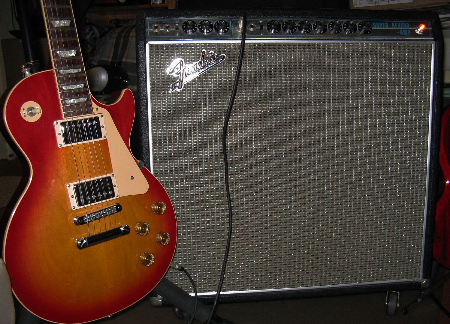

I think the Super Reverb with the 4 10s has always been my favorite sounding Fender amp from that vintage.....black face especially.....
Oh crap, look what I started......beyouuuuuuutiful stuff Booch!

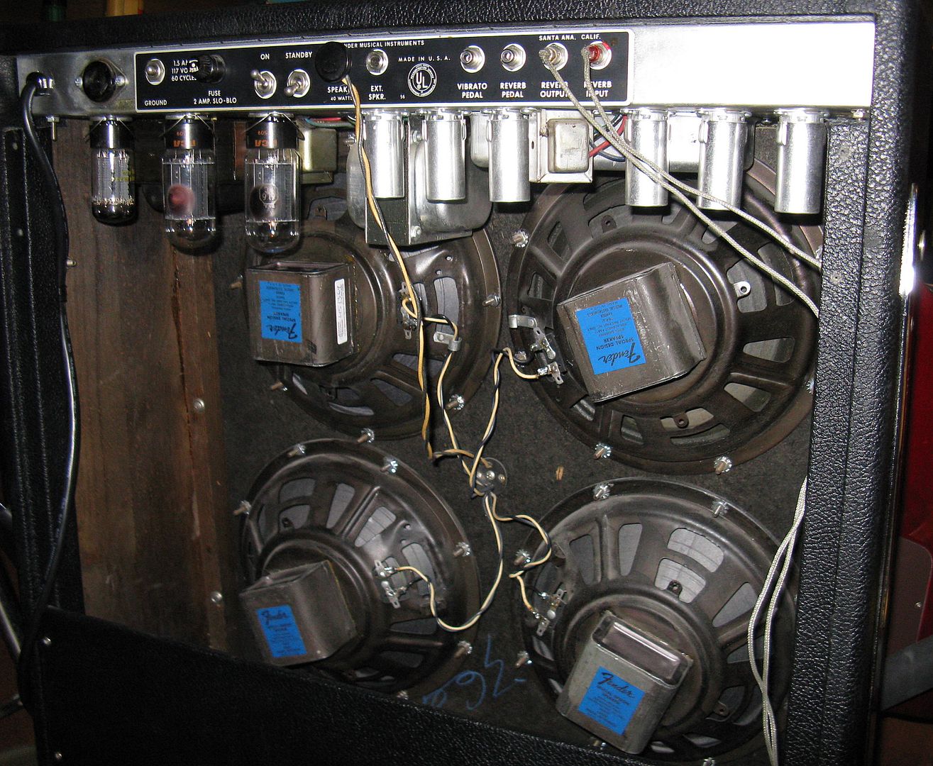

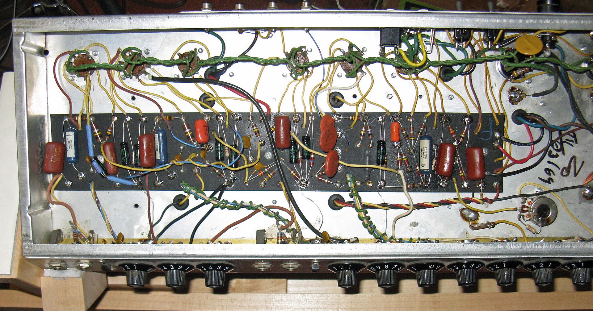

I couldn't find a good BF Super Reverb, but I do like the drip-edge Silverface line. It's a clean, early 1969 model. I reverted the original AA165 circuit back to the classic BF AB763.
Yes, it is loaded with reconed CTS 10-inch alnicos.
