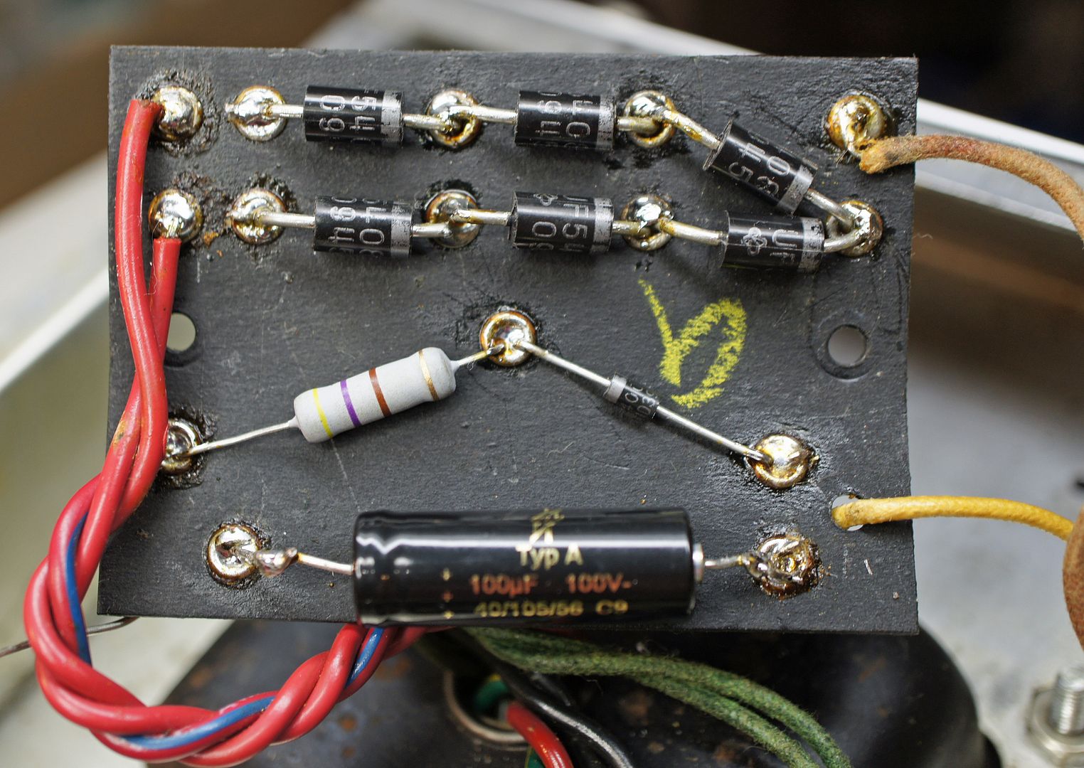

Be careful how you replace components (especially caps and diodes) in the bias power supply section.
There have been many posts on the Net about boo-boos.
Board that has forward facing main power supply supply diodes and the reverse facing bias supply diodes and filter cap.
