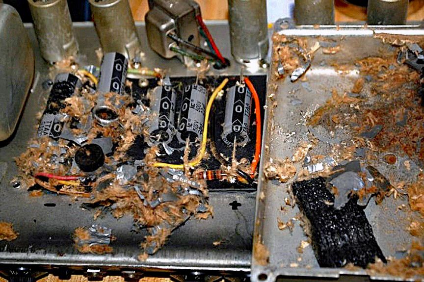

This is just a reminder of what could happen when power stage caps are put in backwards.
It ain't pretty. :(

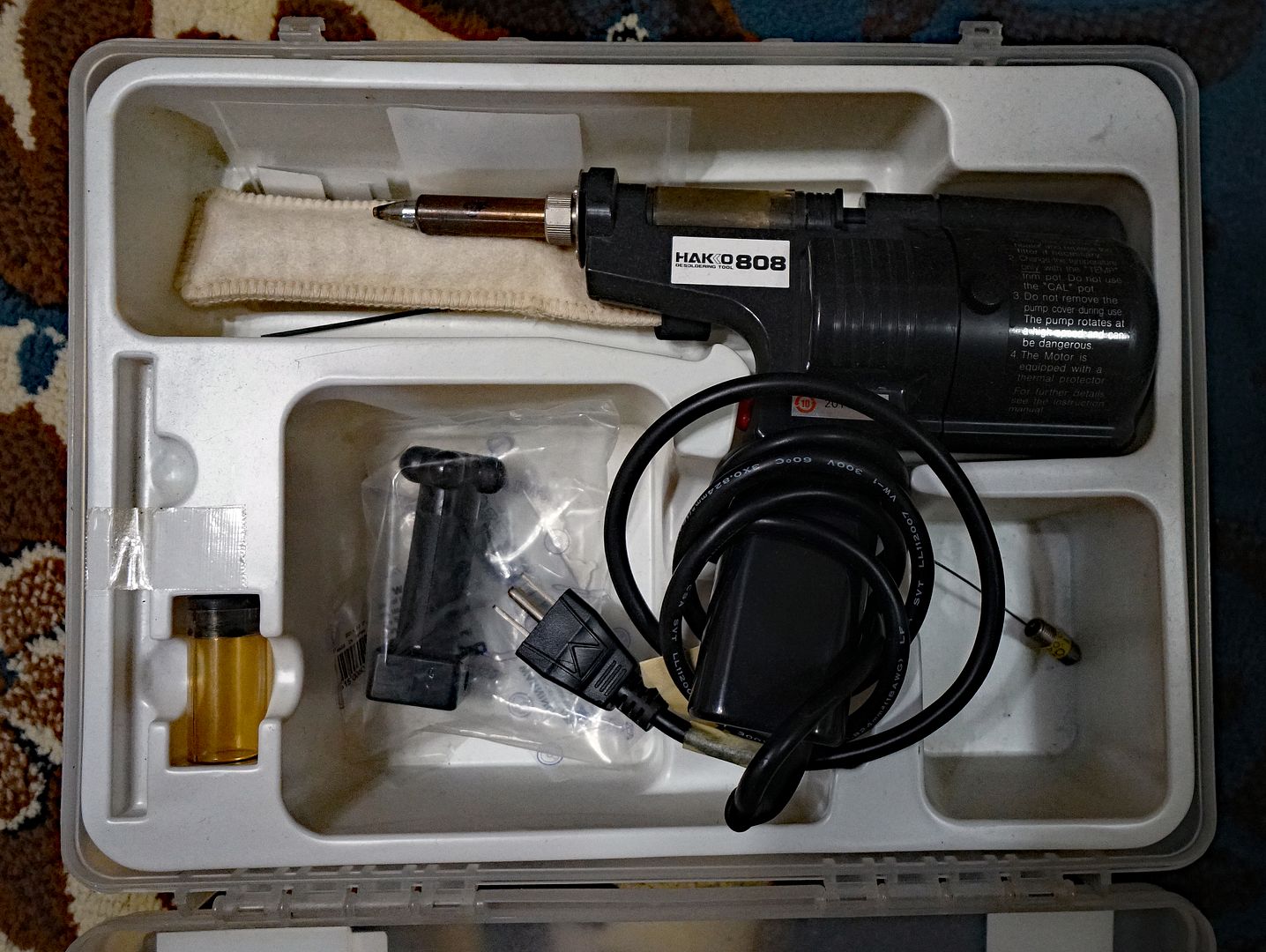

Guess I am late to the party. I use a dual solder station with a solder gun and a vacuum pump. The vacuum pump is great, removes all the old solder so can get the hole clean and ready for installing the new part. It makes those wicks and hand pumps seem like a joke. I can remove every cap and have all the holes clean and ready to reinstall a new caps in very short order.
