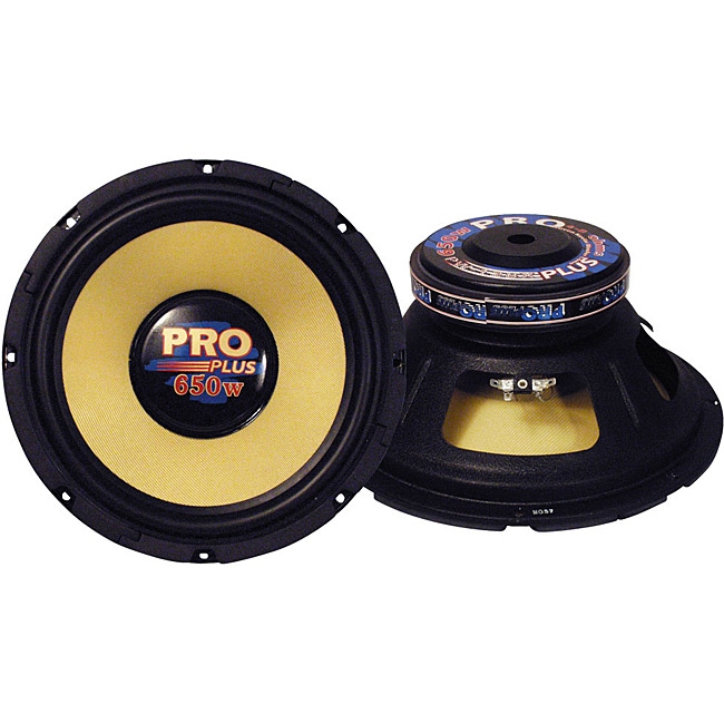

It's worse when they do it just because the foam is shot. The second pair of Infinity Kappa 8s that I bought (cheap, luckily), one previous owner had replaced Infinity's excellent cast frame 12" woofers with a pair of Pyramid 12" (similar to the pic at the bottom of this post) disasters. Luckily I had a surplus of eBay bucks going bad, which allowed me to get a pair of the correct woofers essentially free.
Everything checked out great, one woofer was locked up but it’s a non issue. Those disasters are now no more, the parts will only be used for good honest reproduction, haha.

Things like those Advents puzzle me. That's a lot of effort to go through to avoid replacing the woofers with the correct ones. There's no way someone can think that would sound better, so it must be just cheepnis and having some crap laying around to use.
