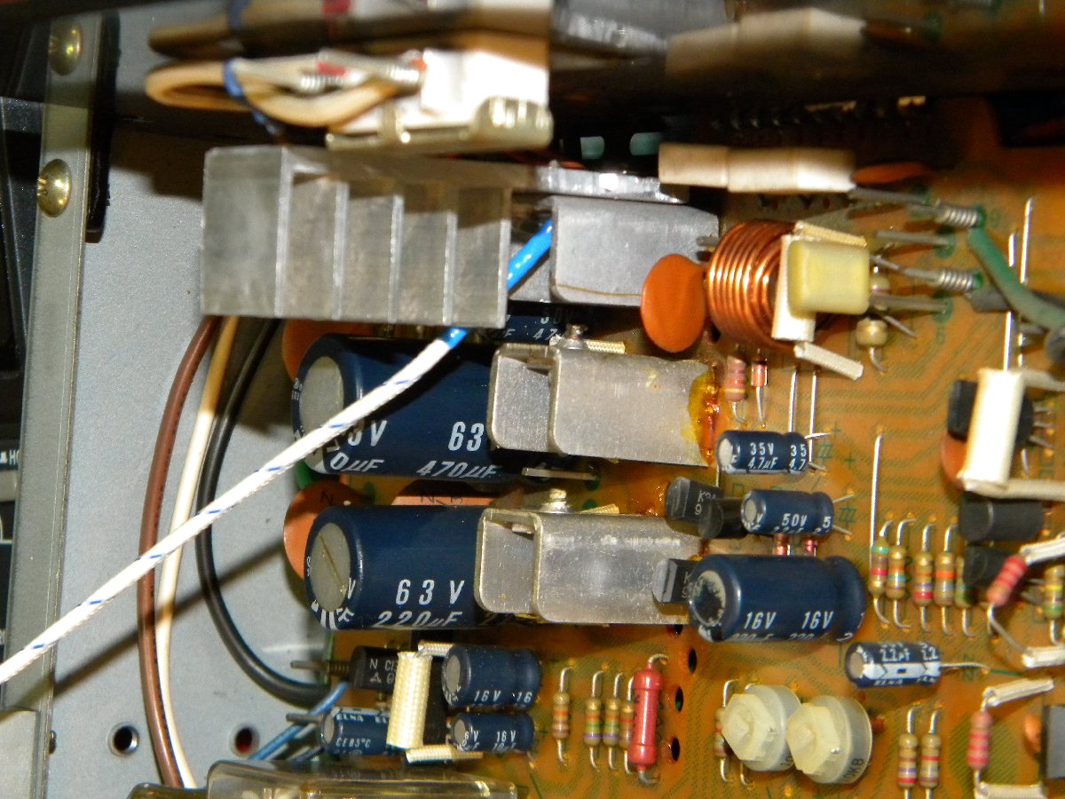

1. GWK-118 board (AF Amplifier Assembly):
Changed all electrolytic caps on this board and 3 transistors: Q19, Q20 and Q25. I applied a new silicone thermal compound (Wakefield-Vette, 120 series) between each transistor and the heat sink but was not able to find a better heat sink for Q25 as Watthour recommended. Below is my recap list.

Q25 NPN 2SD712-C or D MJE15032G NPN (changed to MJE's due to better power dissipation in comparison to original transistor)

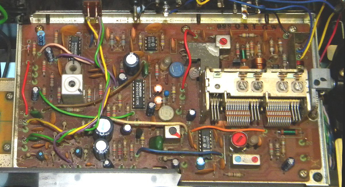

2. AWE-099 (Tuner Assembly):
Changed only two notorious noise-makers transistors on this board: Q7/Q8, 2SA726 to KSA992FBU. The original transistors were gain matched (blue paint dots on the top of each). So, I matched two new transistors as well. I didn't change any caps yet. I think I will do it later keeping a detailed record of which ones and where they came from as zebulon1 and Watthour recommended in case if something went wrong. So far the tuner works great but the frequency is shifted by ~1MHz.

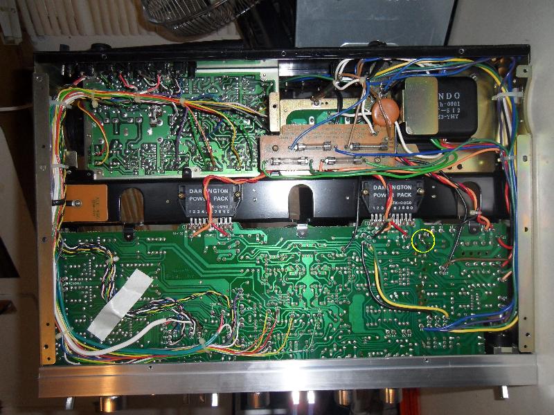

3. Carefully desoldered the output Darlington packs, removed the old thermal paste and applied a new silicone thermal compound (Wakefield-Vette, 120 series) between each pack and the heat sink.
4. Adjusted DC balance and power meters as recommended in the manual. The DC balance is ~5mV on each channel.

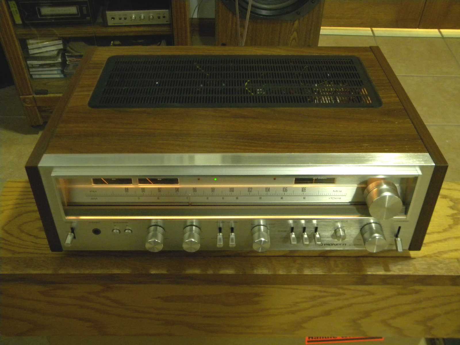

The receiver works great now, looks great and I really enjoy its sound. Thank you all for your comments and suggestions. Below are few pictures.
