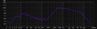

Here is another measurement from DIYAudio of the 18x10 & D2200Ph. It matches my measurements;
Ahhh. For one thing your 2.5mh is in parallel with the 3.0mh? That gets you 1.4mh instead of 5.5mh. If that's true, that's creating the massive bump at 600hz. They need to be in series to get 5.5mh.
Ahhh, I didn’t realize that. I’d assumed they’d be like capacitors and resistors. Since it’s mostly connected with spade terminals, it’s an easy enough fix

Got it sorted. Seems slightly, no, much more refined now. Tomorrow we measure. Thanks Mike and Nick!
