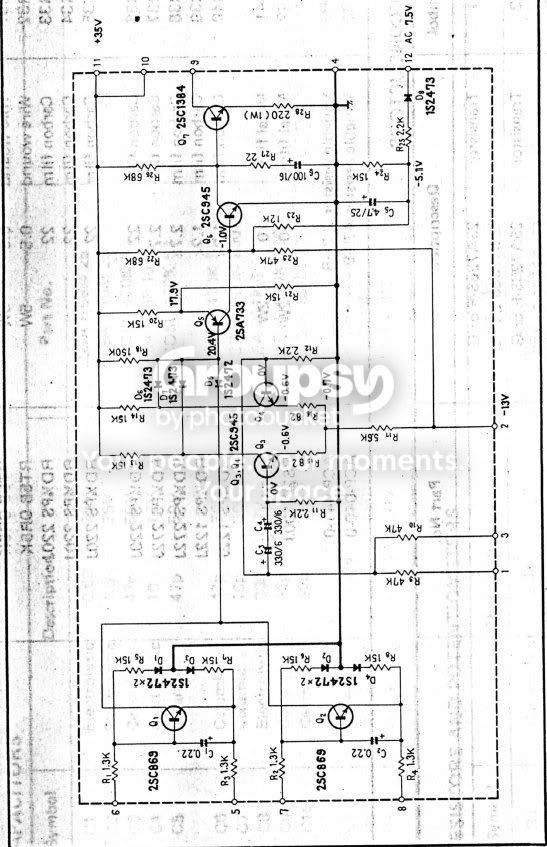

You can connect the voltmeter between pin 1 (and pin 3) and ground, and watch the amplifier's output voltage, it's probably jumping around on at least one of the channels due to all that salt condensed on the bottoms of the transistors.
Did we ever measure the power supply voltages? You may want to do that first, You need to watch these voltages and as the receiver goes in and out of protection to see if they are doing it, the old garbage in - garbage out principle. The amplifiers can't be expected to be stable when the power supply is jumping all over the place.

Okay Mark, I am not sure how to take those readings. On the Protection Board, you want me to test Pin 1 and Pin 3. To test that, the Red Lead of the multimeter goes on the pins and the Black Lead goes on ground. Unfortunately since this is the first ever time I am looking at a schematic, I cannot find ground on it (Schematic Shot Attached). These readings are taken while the unit is Powered ON right? Do you want me to take double readings, one while the relay is ON and one while it's OFF? How about the scale on the voltmeter, I guess I should keep it at 200V?

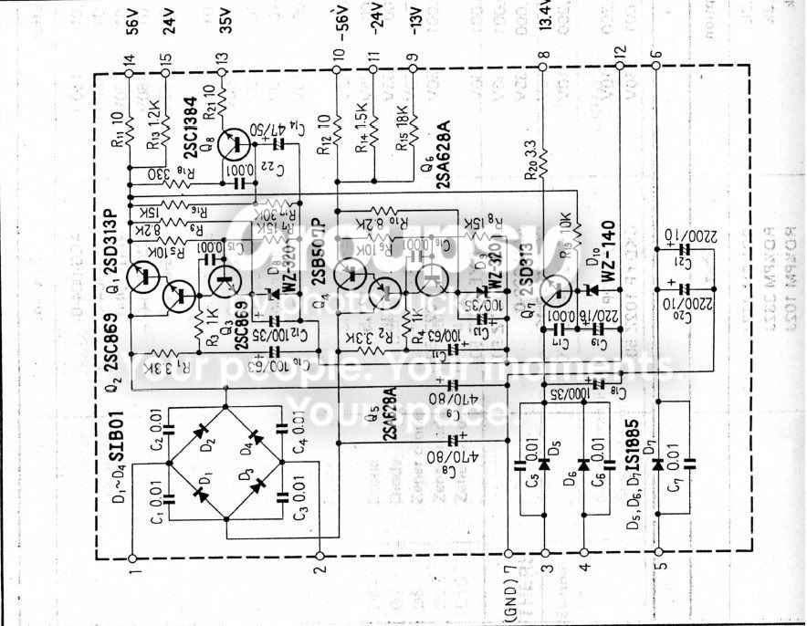

Now the Power Supply Board (AWR-054-A)... Now the attached Shcematic Shot shows ground being somewhere between Pin 2 and Pin 3 but for the life of me I cannot find it, probably I don't know how to look at it.
Edit: Is it by any chance Pin 7?
Other than that, same questions for this one as well. Readings taken while the unit is ON, and two sets of readings while relay is engaged and while it is disengaged?
Nevermind, Pin 7 IS the ground. Here are the readings for the Power Supply Board:

I still need to find GROUND for the Protection Circuit though...
You gotta sick pin 10. Too low. Pin 13 is slightly low with relay on but not much.
The rest look good.
The rest look good.
A sick Pin 10 eh? Well then, we're just going to have to heal it aren't we.
But where is GROUND on the Power Protection Circuit?
You guessed correctly. Yes it's pin 4. :D:thmbsp: You're learning quickly.

I did say Pin 4 but then I deleted it. It was a guess based strictly on the colour of the wire that was wrapped on Pin 4 (Black) and I didn't want to look like an idiot in case I was way off.
You wouldn't sound like an idiot even if you weren't right on as you are learning. Just don't get cocky. :D

Here are the readings for the Power Protection Board. These are taken when the Relay was OFF:
Pin1:
At 20V Scale, it is 0.03
At 2V Scale, it jumps all over the place Lowest 0.019 - Highest 0.039
Pin3:
At 20V Scale, it is 0.02
At 2V Scale, it jumps all over the place Lowest 0.019 - Highest 0.026

NOW to Pin 10 (-56v)and by inference pins 9 (-13v) and 11 (-24v) as well.
That's the AWR054 board.
Zerojunk and i have tangled with that board before:
http://www.audiokarma.org/forums/showthread.php?p=2331911&highlight=AWR054#post2331911
Even though the pin 1 and pin 3 VOLTAGES LOOK GOOD , the protection is not kicking in because Pin 2 of the protection board needs -13v to balance out the circuits, the loss of pin 10's -56 volts also means the loss of pin 2's -13v.Usually the -13v is made quite differently in Pioneer receivers, but on the 1010, this is what we're stuck with.
So we gotta fix the -56v supply on the power supply board.
Q4 2sb507 to-220 bce
b507
one 512-KSA940TU_Q pnp to-220 bce 150v 1.5a 25w 4mhz 40-140hfe $0.54
Q5 Q6 2sa628 to-92 BCE 25v .1a .15w 100mhz 800hfe
a628 (BCE)
two 512-KSA1013YBU to-92 ecb 160v 1a .9w 50mhz 160-320hfe $0.17 ea
D9: wz-320
512-1N5257B Fairchild 33 V, 0.5W zener $0.05 ea
C11 100uf (63v) 100v 647-UPW2A101MHD $0.87 ea
C13 100uf (35v) 63v 647-UPW1J101MPD1TD $0.37 ea
the above parts are just for the -56v regulator, to do the entire board, the parts list in zerojunk's thread can be used, and I'll get the Q designations edited into it for the entire power supply so you can navigate it a bit more easily.
