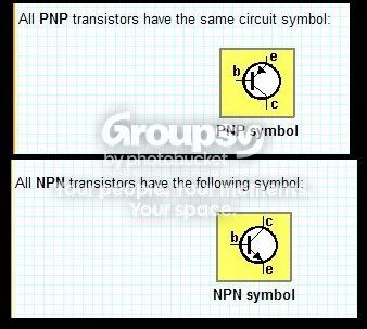

In the off chance that there's something about the schematic symbol that is confusing you about the location of the emitter, I offer this pic:
(the arrow does not point to the emitter, it IS the emitter, and points in the direction of conventional current flow (positive to negative)

Thanks for the picture Glen, it is quite helpful. Though it looks like the 3rd picture I attached in Post #573 above doesn't it? As for getting confused, I wasn't. I was very careful while installing the transistors and I triple checked everything. I think I failed to make myself clear and Mike misunderstood when I told him that I used the Picture in Post 411. I assume he thought I was taking basis the to-92 in that picture (the crossed out picture above) where the Base is indeed the middle pin as you mentioned in your above post. However, I used the Manufacturer's Data Sheet. I imagine that is what Mark was confused about. If I REALLY thought the middle pin was the Base, I would have installed roughly about 10 PNP incorrectly, which probably would have been fatal, not that it already isn't.
Sure...but you added that pic after my post. ;)
