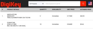

OK, I'll bite. What is an alternistor? Never heard of that before and I've been monkeying around with electrons for 50yrs. lol
An alternistor is similar to a triac. They're used to keep the power switches from getting destroyed. When using an alternistor on a power switch the snubber cap isn't needed. The snubber is needed with a triac.
There are isolated triacs and alternistors that don't need mica when they are attached to the chassis. Just a little thermal paste and fasten them down.
To understand them read this thread:
https://www.audiokarma.org/forums/i...-hour-or-so-of-your-time.504673/#post-6552885
I have modded all my receivers with these.
Now, the factory switches (made of unobtainium) only need to carry minimal current. Winning.
