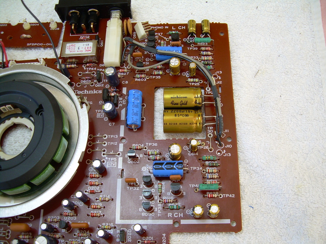

The MC part of the SL-10 is a very nice Step Up Transformer (...)
Sorry, but no, it isn't - that's an active gain stage (with disctrete transistors), not a SUT. Check the schematic in the service manual for verificationn, in case you wouldn't believe me.
exactly, in addition to the manual also the photos confirm this.
