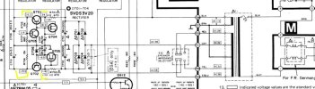

Seems every time I hook this amp up to my source and speakers, something new happens. Since yesterday, frustrated that I'm limited in skills as well as equipment, I set about cleaning the RCA ports with a bit of IPA.
Then I connected my turntable and speakers, with the top off the amp to follow @SVI2004A's advice. But before I could even search for a dry joint, both speakers started playing.
For the past hour I've been trying to assess the sound on each channel. I think there's still a lower signal through the right speaker, with room for improvement but strong enough that I'll count it as basically working.
The right channel seems to drop every now and then, but comes back if I jog the RCAs and/or the loudness button? I'm relieved that at least part of the issue was down to dirty connectors, but also a little disappointed I didn't get to solder anything :)
Thanks all for your advice, I'm sure we haven't seen the end of this thread yet!

Yay, I still get to solder something! :cool:
If all I learn from this is to clean my connectors, I'll be disappointed.
You will probably find, with a magnifying lens, a few cracked solder joints, especially in components that normally work hot. Use a soldering iron at 350C and redo the solder joints. You may have to remove the old solder if needed. If so, you may use solder wick with flux. This guy in this video explains well, in my opinion. I am still not good at soldering and desoldering, but I am still learning too and getting better.

About power amplifier restoration, for this one, and the next ones you will buy ... , you will need dummy loads to connect to the speakers' output to adjust the bias of the output power transistors. This is for Class A and Class AB amplifiers. You should buy two 8 Ohm, 100 W, resistive dummy loads. I suggest you put each in a ceramic mug during the bias adjustment, as they will become very hot. ( Please see the link below from @mrk229 ) Good sources of original/legitimate components are Mouser and DigiKey, as you might already be aware.
Your amplifier uses a 'Power Pack' (integrated circuit) in the output, so this bias process might not be needed, but it is a good idea to have those dummy loads for future projects.

On main board, check for dry joints on pre drive transistors (2 red sections) and current stabilisers (orange area)
Before removing bottom panel, remove screws in green circles.
ElectTech yes, bias in this set is set within power IC… but also influenced by current stabilisers that are controlled by the ICQ controller IC (MN1404STE)
