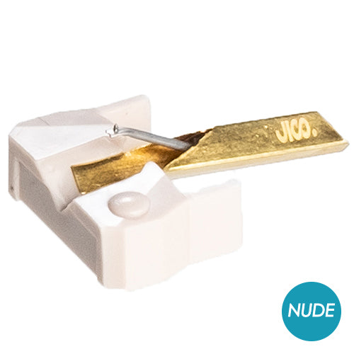

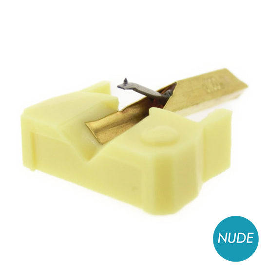

As previously stated, it was made by CEC who made turntables for Marantz, Pioneer and many others. They are well made and sound great when properly setup with a quality cartridge.
The cartridge appears to be a Shure M75 type with an extremely cheap after-market needle. The cartridge is a keeper but you need to ditch that pos needle.
At this point, I have really nice stuff. A fully restored Marantz 2270 with engraved faceplate, a fully restored Marantz 2230 with engraved faceplate, two fully restored Fisher tube amps (a 400 and an 800C), two more unrestored (another 400 and an 800B), a Lowrey tube amp converted to stereo hifi (I call it my FrankenLowrey), a DS-1 single ended tube amp, Klipshorn speakers, Coral BX300 speakers, ElectroVoice EV4 speakers plus streamers and good quality DACs.
with equipment like this, there is no excuse to use a cheap needle
the Shure M75 series are excellent and as good as any so called "high-end" moving magnet cartridges produce today, but only if it has a quality stylus
these are the best available for the Shure M75 series
3/4 - 1-1/2 grams tracking force
1-1/2 - 3 grams tracking force

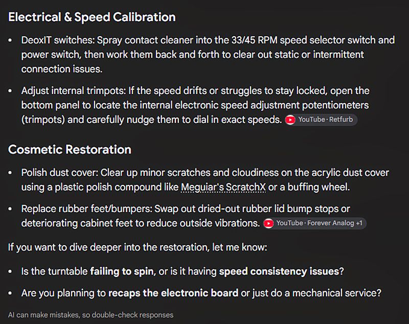

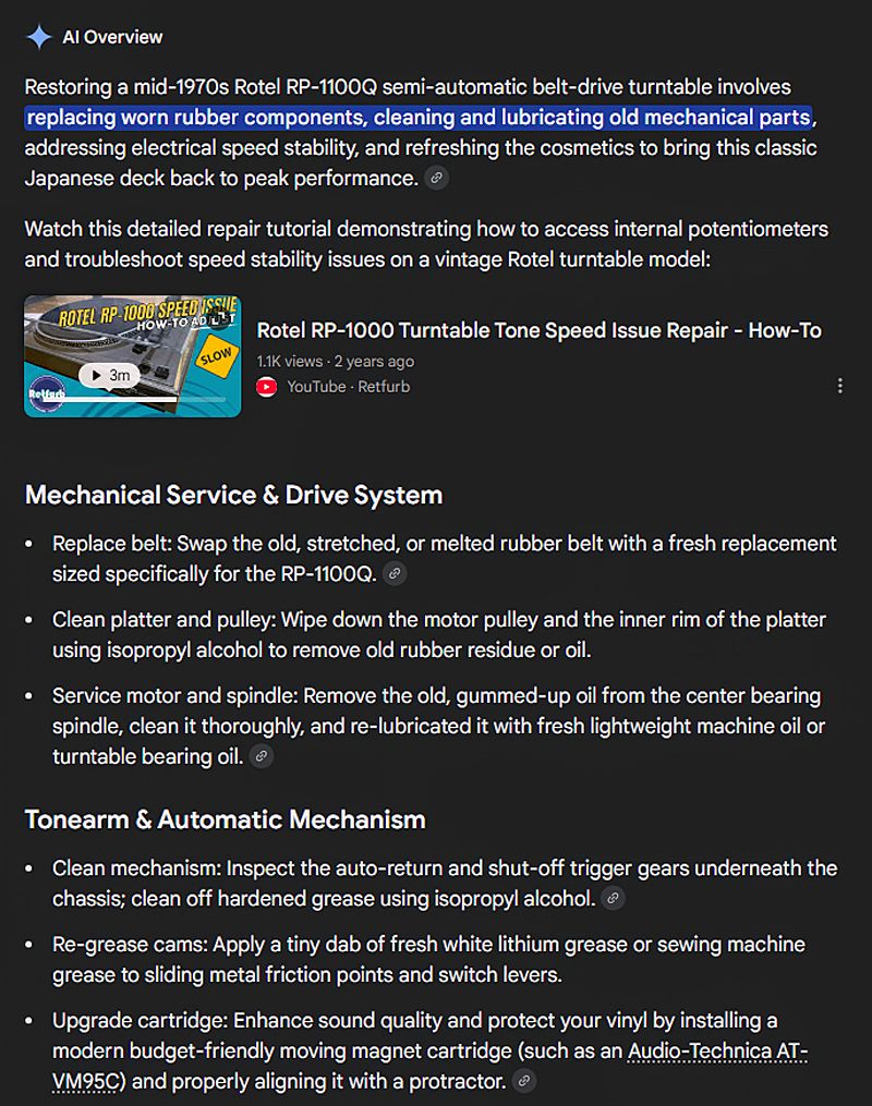

This is what Google AI came up with. Hope that it helps.
:thumbsup:
This is the link to the Rotel RP-1000. WARNING: The RP-1000 is a direct-drive table. I believe that yours has a belt. I don't know how the electronics differ.
A schematic or service manual for your table would be a good thing to download.

I do not know if the stylus is in good enough condition to offer a fair trial. Consider replacement with a VM95C.
Do you mean this one?
More than I paid for the turntable but a very reasonably priced stylus just the same.
