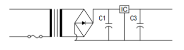

I was hoping you could touch on the change to the power supply between the Bugle2 and Bugle3. Why the change from the diode to the resistors?
Bugle2
Bugle3
Great question!
First, I didn't feel the reverse polarity protection diode was truly needed, as I figured I would be building all units and providing the correct power supply. Did not foresee me offering the Bugle3 as a kit PCB at that time.
Usually, the problem is not reversed polarity when built as a kit (Bugle2), but rather connecting a power supply where the negative terminal was connected to ground (should be floating). This ends up frying U1. Protection diode does not help. So heck, I took it out.
The resistors are for an entirely different purpose. They were added to load down the wall wart with extra current. Why? Well, the Bugle design does not pull very much load current (which is also why the B2 and B3 do not have on/off switches). At 240V operation things start to get marginal with some brands of wall warts in that they go into pulse-skipping mode (for light loads). This causes an audible whine in the circuit, as the pulse-skipping behavior (start / stop / re-start) is smack dab in the audio spectrum. By adding resistors, the extra load current pushes the wall wart back into continuous mode where the switching frequencies are ultra-sonic, and easier to filter out. This is also why the 1mH inductors are on board! They (along with the 200uF capacitors) filter out all that ultra-sonic noise, leaving behind a decently quiet set of power rails. Opamp PSRR does the rest.
Thanks Jim! I have an extra linear supply with a 7824 regulator.
Any issues with this or should I order the switching supply?
Using a linear supply will provide a quieter DC input to the Bugle. Per the drawing you should be Ok. U1 will create a middle point which then gets tied to the shield return of the output cables, and that ends up getting tied to Earth ground in the linestage or receiver. This topology minimizes ground loops.
