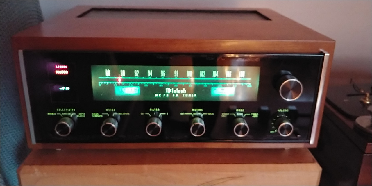

I've had/heard a lot of tuners in my 40+ years of audio experiences, including a few Mc's, although not a 74. But I must say after spending some time now with a recently purchased 78, I'm satisfied that it's easily one of the best I've ever heard. I can pick up my priority small college stations that are 35(500) and 45(250 watts) miles away, and a very small community station(160 watts) that is 23 miles away. All very clearly, with a rooftop antenna.
I would love to hear the 74 one day, but for now this one will do fine.

The antenna is a standard, old non directional rooftop type that was on top of the house when I bought it in 1998. In other words nothing terribly special or unique, but it does the job. I would think that if I upgraded to a modern, directional version I would probably improve my signal some, but as I indicated the 78 does a great job of pulling in the stations I care about so I'd rather spend the money on records:)
