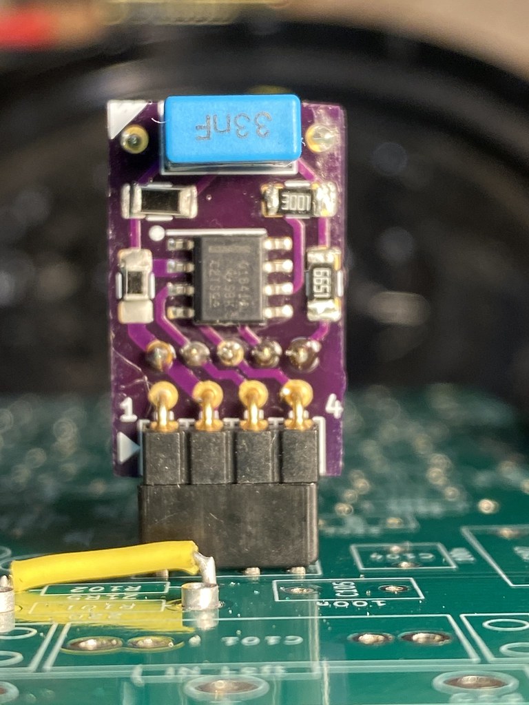

For those who have the v1.3 boards @HalfApt ( Sean) came up with a mini daughter board to allow the older V1.3 boards have the ability to use parallel op amps which are better than single.
Her is a post from that thread..............
I built one of the MM Parallel daughter board assemblies for the v1.3 boards.
@HalfApt , I looked at R5 on the main board and it was 3k so I took the liberty that the SMD resisters R5/6 ordered were suppose to also be 3k and not 75 ohm .
Also in the build notes you gave, it looks like the L headers touch in-between the boards and obviously they shouldn't ....correct? So I cut them short as not to touch.
I figured out the best was to solder the parts on was to first use solder paste for the op amp, then do the resistors then cap and headers with the two support pins
at the top last, which one I lost. So I used resistor lead. Solder paste does not work for the SMD resistors , as it heats up it bubbles and pops and flip the resisters over.
I probably could hold them down with a tool but doing the same with regular solder and thin iron tip worked out fine.
When soldering the joining header, first solder it on one board and make sure its square. Then use the socket on the main board or if you have an extra use that
to align the distance between the two boards. I added a small piece of foam towards the top of the board to separate it up there while soldering the second board to the existing soldered joining header trying to keep the boards evenly distanced along the entire length.
Here are some pics, this did take more time than I thought it would for so few parts. I 3 more assemblies to build .
One MM v1.3 board now a parallel amp board just like v2.0 ( minus warp filter) .

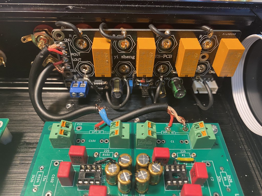

Did you get a schematic with the boards? If not, and if you can get good straight-on close-up photos of both top & bottom of the relay board, I might be able to figure out the schematic.
When you first posted about this relay board, I thought you were planning to mount the RCAs to the board. That option is clearly intended, as evidenced by the hex nut outlines on the silkscreen.
But if mounted to the board, then the RCAs can't be chassis mounted, unless you use RCA jacks with exterior threads.
Are the board mounting hole pads connected to ground? If so, the board will have to be mounted on insulated standoffs.

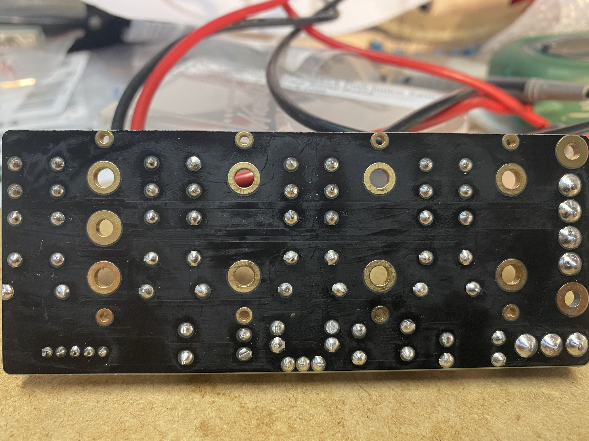

No Schematic. But I just tested if the GND for the inputs has continuity with the chassis , and it does not.
But here are pics of the front and back. One thing though is these PCB's are thick and hide the traces, unless you can make out the raised areas, those are the traces.
Also it says 12 vac but in the Bay description it says it accept 12-15 DC as well.
But looking at the board I was wondering if I can connect the DC to the board after the rectifier diodes since there is no need for rectifying the DC source.
And if So how would that be done?
Click for large pics
In this next pic you can see that I can mount it to the current RCA's . The signal is easy to connect but for the GND's I'll have to use wire jumpers from the RCA's to the board. No biggie.
And @mkane gave men\ an idea as well about using parallel load resistors. I can run the outs from the relay board to a rotary selector switch right next to it with
a set of parallel load resisters 10k, 47k and 100k .
Here is how the board fits perfectly on the RCA's
See how the signal soldering pins fit perfectly in the holes. I will just bend the GND lugs flat so they do not touch the board and solder wire jumpers that will come from under and over
the board to the front. Solder to lugs first, fit board, solder signal pins then GND's . . I may desolder the power triplet and flip it so I can access the connection with out having to either remove the bottom panel or desolder the entire board.
And here Is how I think the new layout inside would look now with board on RCA's.
Except I'd flip the MC board around so the inputs are at the back panel.
Lots of work but I think this will be an epic build.

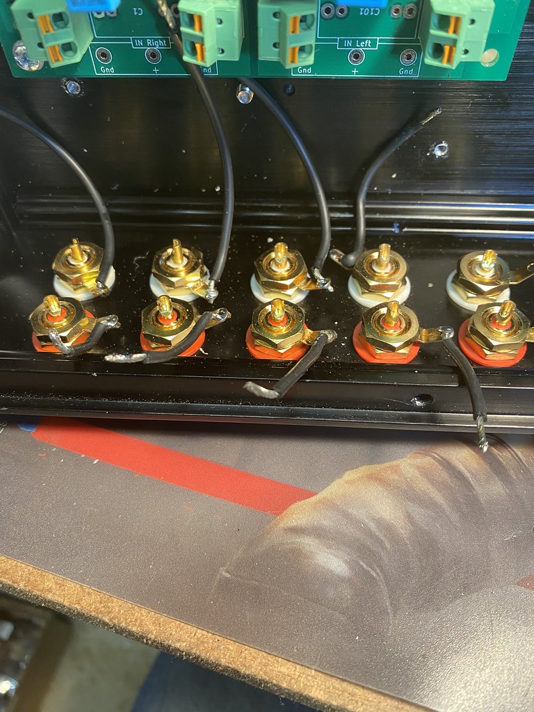

Was back at it tonight. Wired in the input wires for the relay board to the MM board and the single MC input.
First I had to solder in GND jumper wires to make it to the front of the relay board.
I forgot to connect each GND to each other , But I addressed that later....I think its ok how I did it.
Then I fit the relay board over the socket pins and solder in the jumpers and center signal pins.
Here is the outs from the relay board to the MM board.
Here is the MC input soldered to the MC board and how I dressed summing the R to L GND's , on the relay output I solder a jumper to the L and R GND out, the thiner red wire . I think this will be ok as I tested and all GNDs are connected not via the relay.
And here is a shot of both boards connected to the inputs.
I used Mogami Microphone wire for all the inputs and will use it when I wire each board to the MM/MC switch and back the the Line stage
on the MC board.
Took me some time as it was difficult to solder the relay board up, especially the bottom GND's. Only after I was done I realized I could
have removed the bottom for easier access to those solder points.
Also on the relay board I removed the triplet power connector and put in a dual and revered the input side for easy connection. This board only needs a GND and + 15 VDC connection.
Also removed was the output block terminal , that is where the outs were soldered directly to the board.
Tested for any shorts that may have occurred between signal and GND and the input GND's to the chassis. No continuity there so so far so good.

Certainly exposed switch contacts have the possibility of corrosion and the acquiring of some non linear (rectification) properties, and the resistance is non zero, but I have seen little evidence for this as a generally true statement. Certainly using sealed relays allays some of these concerns, and using the switches to short to ground rather than go open also tends to be a better approach. Also switching into relatively high impedances has advantages (and disadvantages).
The phono stage/preamp normally has only two switched sections- the Warp filter (in/out and gain) where the switching is either to ground/open or with only the LF warp signal in series- or the input selection function for the line stage.
In general, in my opinion, relays are better than mechanical switches when small signals are being switched.
In my own preamp implementation I have used a similar relay bank to provide source switching for the line stage.
Thank you Wyn.
In a few of my preamps and a Bryston crossover with wafer switches, even enclosed versions (but not sealed), I've found distortion and signal dropout using my oscilloscope. The worst was the Bryston, despite the high quality switches used, probably because it had been sitting in an attic for 20 years. That was the least of the problems I had to solve, but it took several cleaning and lubricating cycles to get a clean signal.
