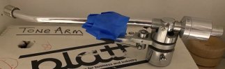

Hey gang, I need help identifying a tonearm. I am assuming this is a Kenwood KD-550. Am I correct?
If it is a KD-550, I've already download the documents from Vinyl Engine. That gives me the measurements of the arm, but I can't find a template. Which is a bit of a challenge, because I intend to install it in a Sota Sapphire.
