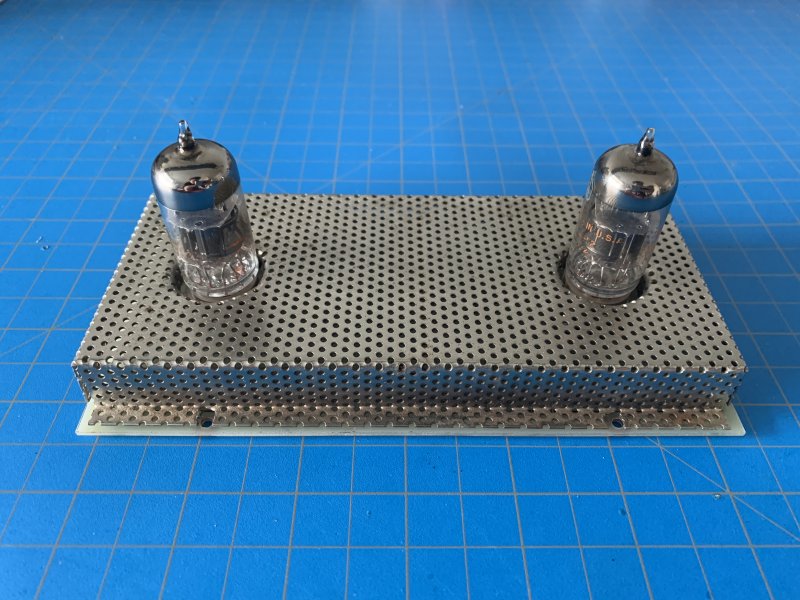

Alright, first hiccup. My st70 came with this nifty screen that fits over the PC board. But it will not fit the replacement board from dynakitparts. It seems the position of the tube sockets is about 1/4" wider that the original on each side. It makes me sad because the screen is really nicely made, perforated stainless and nicely bent. Definitely not shoddy craftsmanship making that. It looks like I'll have to replace it if I want to use the replacement board but dang it the shop isn't well set for sheet metal fab' and milling it on the Haas milling center will probably make even less sense.
I made a complaint last year to Dynakitparts about their replacement boards not working with the OEM cover. He even told me that they were aware of it, but due to several dimension differences between boards a compromise was needed somewhere. I asked him why don't you put that info on the website so people who have and want to use the OEM cover will know about it. He said it was a good idea, but they still haven't. I would think when making compromises they would make the tube socket location high, since there is an OEM cover which depends on it. Unfortunately you and I are both unable to use this cover any longer which was one of the unique things about a factory wired ST-70.

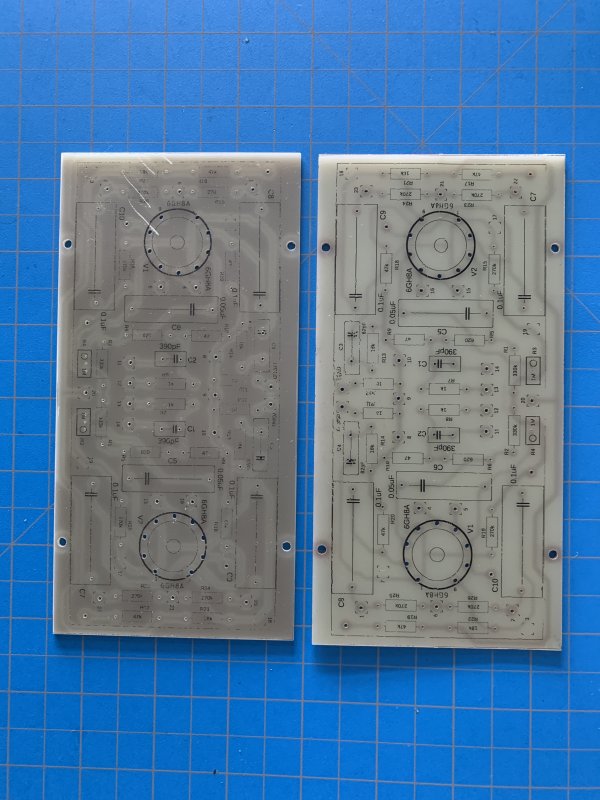

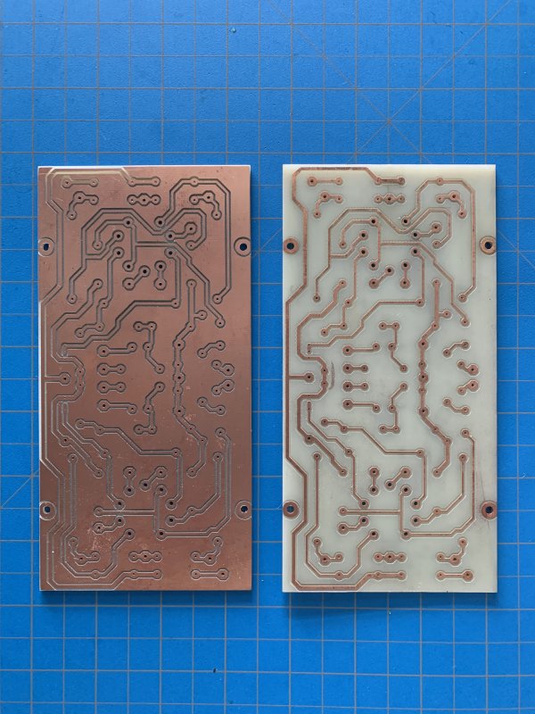

Thanks for the information it's really helpful! That's really disappointing that they are well aware the replacement board will not properly fit some factory wired st-70s but they won't say a word about it. I had crazy busy days at work but in the little time I had, I drew up the schematic and (initially) copied the part placement of the original board. It feels like routing for the 6GH8A tube is a little awkward compared to the 7199s but if I route for double sided boards, it's a snap. This btw is what dynakitparts did too, so I can't say that I'm buying that they had to compromise between tube placement and routing possibility. Specially that the board is pretty large and has tons of breathing room for 1-1.2mm traces. After looking at the routing, I decided to go a little off-script and moved a couple resistors and placement of wirepads to let the traces breath. This also made it so that I could easily route for a single layer board. Next is etching and silkscreen printing. I decided against sending it to a small PCB shop to keep alive the spirit of DIY'ing in this tube amp. So everything will be made in house.

In the meanwhile I got two boards made, one with just trace isolation and the other with bare traces. I'm still not sure which one I'll end up using; the plan for the trace isolation was to use the unconnected plane as a ground plane. It has plenty of clearance for 600V and adds the benefit of screening. The bare trace one looks more familiar though and it has no chance to arc. I'm attaching a picture of the screen too to see the fitment. As you'd expec, the silkscreen printing is a hit or miss, but that's something that happens when you print at home. If the OCD kicks in, I'll just wipe it off with strong acetone and try a couple more times.

Wow they look very well made, I'm very impressed with how they both turned out. Put one in now and report back on how it performs for you. Didn’t take notice, are these for original tube or the sub?
