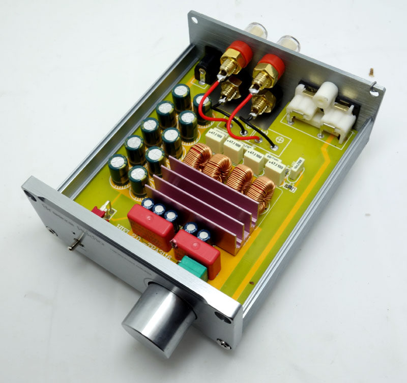

Anybody can comment on this new board/amp?
http://www.ebay.com/itm/161353017315
Do they use a picture to sell this amp with a burnt red Wima capacitor or burnt fake Wima???? It sure looks like it... ROFL it is a 400V capacitor on input, burnt with 2V???
This is a better picture of the Wima. I have no idea how to tell if they are fake or not. Maybe someone can tell.
Hah indeed it does look burnt. By a solder iron, not by current going through it im sure :)
Otherwise, the circuit looks pretty similar to the B&B board. No telling if those WIMA's are real I guess.
mmm looks burnt out from the inside, burst open from the inside. I have seen several films like that in old televisions, high voltage picture tube:) but here with like 2V max, no ripple, I would say unbelievable :) or this amp has been rigorously tested :D
Sanyo stopped producing electrolytic capacitors april 2009...but maybe here they are not labeled Sanyo's, can't see clearly
