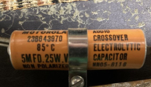

Hope I’m not a pest. Was hoping to just get input on selecting new crossover electrolytic capacitors based on these oldies:
I understand I need 5uf, just want to make sure I look for the correct voltage.
Thanks,
JP
I would replace this with a 5uF film capacitor, not electrolytic. I think film caps sound better than electrolytics in crossover networks. Looks like 25 "WVDC" (but the clip covers up part of the rating). Something of at least 50V rating for the film cap would work. Physical size becomes limiting as the voltage rating of film caps goes up, but they are in generally pretty small compared to the old types. No polarity to worry about with a film cap in a cross over, either.

in theory any electrolytic can be swapped for film, but size and cost make it not practical most of the time.
Other option for the crossover is a non-polar electrolytic. Thats what the original is. Cheaper, but the film is the better option.
