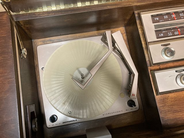

Speaking of head scratcher, I had a dummy moment today (which is fairly common for me). I cleaned the record changer motor today, just to see if it was “alive” and worth continuing work on. The phono power harness comes from the tuner vice the pre-amp, and while I turned the pre-amp setting to “Phono” I neglected to .... wait for it ... shut off the tuner. So, nothing happened when I turned on the record changer. Checked the voltage coming from the harness on the tuner, and barely anything. Wired the changer motor directly to power and it worked great. Finally, it dawned on me to turn off the tuner. All of a sudden my voltage meter showed plenty of power coming from the harness. Plugged it into the changer and the motor came to life. I’m so used to integrated, solid state components, it didn’t dawn on me to shut the darn tuner off first. :rolleyes:
So, despite a little ignorance causing some panic today, it was actually another successful day. I still have to go through and clean the rest of the record changer, but I’m happy to report it’s alive and looks promising! Also, replaced all of the #1847 bulbs with LEDs...so nice. Got warm white to keep things original looking.

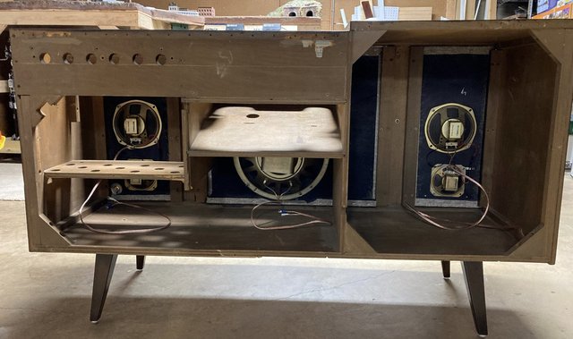

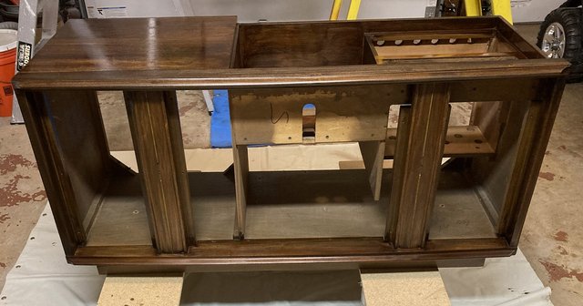

While I’m waiting for record changer parts, I decided to tackle the cabinet this weekend. As I mentioned before, this isn’t the higher end Drexel cabinet. The top and sides actually had a very thin laminate (not wood veneer), which I sanded off. The wood underneath the laminated surfaces is cabinet grade plywood, and the other wood trim is a softer type wood. Each took the stain a little differently, so I went darker (walnut) to try to even things out. Did I mention I hate wood finishing!! Plus, it was rainy and humid today. Good grief. I’ll be doing the polyurethane throughout the coming week.
Looking forward to working on the record changer and getting this part of the job behind me.
Cabinet looks great. I like that a lot more than the original color.
Thanks, Gadget. I let the stain sit a little too long on the top and it is staying a bit tacky in spots, so I have some fixes I need to make, but I think I should be able to correct things. Yesterday’s humidity didn’t help things.

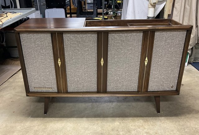

To contrast with the darker finish, I have a simple, lighter colored grill cloth (I think a replica for Vox guitar amps) that I am hoping looks nice. It’s slightly darker than the grill cloth I have on some AR speakers on my basement system, which I really like. Looking forward to getting past the staining and poly part of this job.
I haven’t had as much time in recent weeks to work on the console as I would have liked, but I was finally able to get the grill cloth, speakers, and trim hardware installed in the last couple days. I’m hoping to get the components (sans record changer) back in the cabinet tomorrow along with the lift top. I received parts to rebuild the record changer about a week ago, and I hope to tackle that in the next week or so. Appreciate all the help I have received here to get to this point.

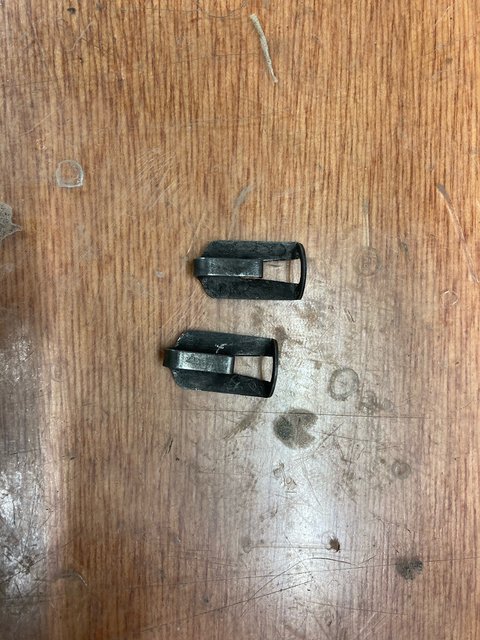

A couple questions. I’m being defeated by the clips used to mount the VM record changer back into the cabinet, and I didn’t take pictures of them before I pulled the changer last month. Does anyone have a stupid simple guide or pictures to get the screw properly attached to these clips:
Second, I was playing the system today for the first time since reinstalling the speakers with the new grill cloth (pictured in my previous post). The grill cloth is a replica for Vox guitar amps, and it has almost a vinyl/rubber-like texture woven into the fabric. When the bass is turned up much past 3-4 and the volume is below halfway, the fabric vibrates quite noticeably at the opening in the wooden mounting board for the center channel woofer. Other than at those openings, the fabric is glued down and stapled quite tightly. The speaker is not the original Golden Voice ceramic 12” (had a bad cone), I placed it with an Alnico 12” that came out of vintage Lafayette. Any ideas on what could potentially be done to stop the loud vibrating...short of changing to a different kind of fabric?

they shouldn't have to come off, they will just flip up to go out. Pulling them is kind of a PITA, putting them back on isn't much fun either. I'd do this out of the console otherwise its just pure hate.
anyway, slide them back on, then stick a screwdriver under the tongue of the clip to get it to slide past the screw. Pull the screwdriver and the tongue should drop down and hold in place.

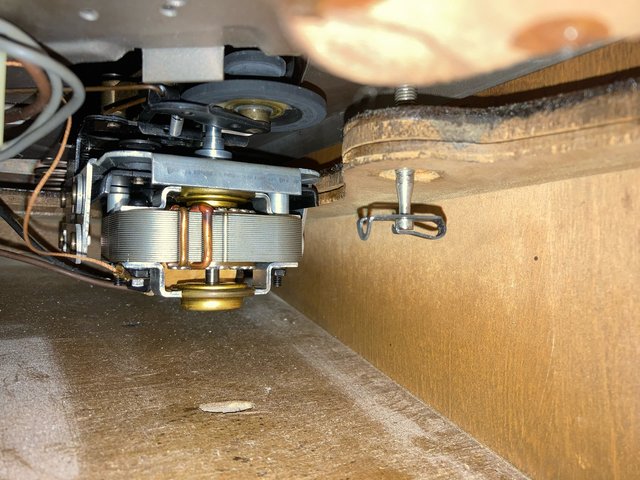

Thanks, gadget! So, I can get them on like you described. But then the problem is that there is about 3/4” gap between the cabinet and the clip ... i.e. the clip doesn’t hold tight to the cabinet. Could it be that the spring shocks on that the changer sits on are compressed? The foam insulation that was in the springs completely disintegrated when I pulled the changer.
I thought I remember the clips being tight to the cabinet. I’ll take some pictures if my description is lousy.
EDIT- Picture showing clip installed
Its supposed to float for isolation. The clips are there as a transport lock, back the screws out until the clips pull against the cabinet and it sucks the changer down to keep it from bouncing around when being moved.
Well, son of a gun! Thanks for clarifying, Gadget. I think that is what the previous owner had done, and that is why I remember the clips being tight to the cabinet.

Well, file this under “you can’t fix stupid.” The reason I am getting the vibration from the “grill cloth” is I installed Tolex wrap and not grill cloth. The wrap was mixed in with the grill cloth on the site I purchased it from, and I wasn’t smart enough to know the difference. I still have two more yards of it left to remind me of my shame. :rflmao:
So, it looks like I will be pulling the speakers back out and re-wrapping them with actual fabric this time. I really like the look of that darn Tolex, so I am hoping to find something similar. I’ll chalk it all up to a good learning experience if I ever do another one of these.
But for any other “newbs” out there reading this, Tolex ain’t grill cloth. Save yourself a $50 mistake!!
