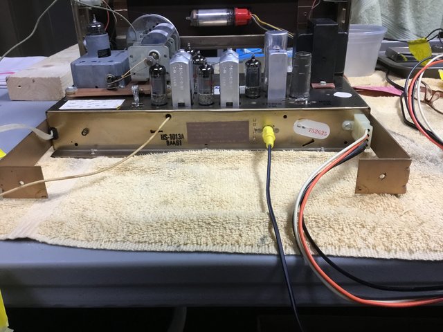

Thanks for sending the resource, Tom. There are two markings on the tuner chassis. There is one stamped on the body that says HS-1013A, and then on the side of the tuner there is a Motorola paper label that says HK-45-2. I’ll do some digging on the Radio Museum site.

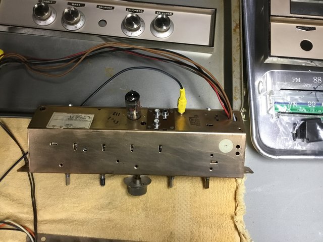

I do have one more question. The FM Stereo tuner has a single RCA out to the the pre-amp, but the input on the pre-amp has right and left inputs, as you would expect for stereo. I’m confused by the single RCA output on the tuner. Can I get a splitter cable like the one below to hook it up properly? The unit arrived with just a single RCA cable out to just one channel on the preamp. Currently, with the pre-amp in mono mode I can still balance right to left with monophonic sound, but when I set the pre-amp to stereo, only the channel I connect with the single RCA connection works, which makes sense.

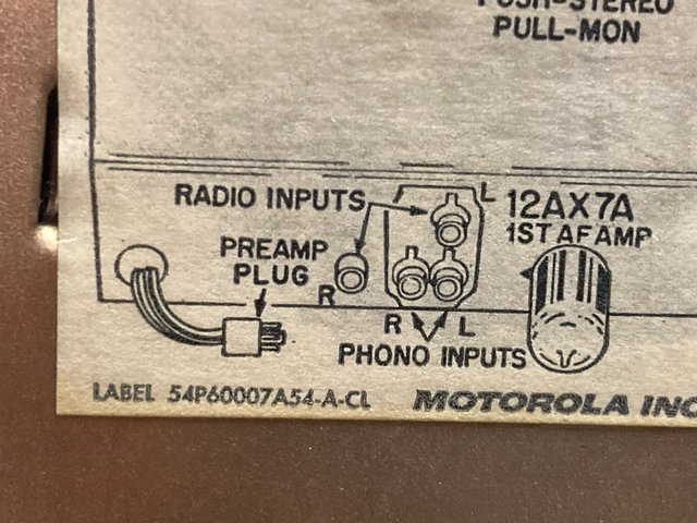

Input diagram on the pre-amp:

That would feed to the external multiplexer. One in, two out. Usually has 2 or 3 tubes on it, a couple of cans, and a bit of magic to make it actually function. If this doesn't have one in the cabinet, there should be a selector position for "FM" and a second for FM MPX or FM Stereo. Just use the one that isn't stereo and it should give you mono FM from all speakers. The FM MPX output doesn't filter the 19khz pilot tone or provide the proper de-emphasis the mono connection does. That stuff would have been handled on the multiplexer.
Thanks, Gadget...the cable explanation makes total sense now that I think it through (I had it bass-akwards). The tuner has three settings, FM, AFC (FM), and AM. On the pre-amp’s balance dial, it is pull for Mono, push in for Stereo. When in Mono mode, all speakers fire like you said, when I put it in stereo (FM or AFC) the left channel (because that it what is connected to the tuner) fires, along with the third channel (woofer) ... nothing from the right. While I know I will get stereo from the record changer, I don’t get how Motorola could advertise this as an FM Stereophonic Tuner, but set-up as it is from the factory, it can only produce mono FM? Perhaps the original owners didn’t pop for the extra multiplexer feature?

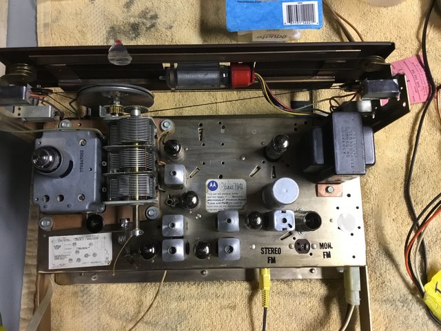

You are not supposed to use that FM stereo output jack connected to the preamp. It goes to an outboard multiplex adapter which was either pirated or the original owner didn't spring for one. My Motorola 3 channel is old enough that it didn't have FM stereo capabilities. It has a mono tuner but stereo turntable. When listening to the radio, I have to select mono on the preamp controls to have sound in all 3 channels.
The tuner should have regular left & right outputs somewhere on it that connect to the radio left & right inputs on the preamp. Using that FM stereo jack to the preamp, you should have no AM so there has to be some other connections. Can we see some good all around pics of the tuner?
With the original Motorola multiplex adapter, the FM stereo jack would go to the multiplexer and then the multiplexer would have a special plug which goes to that FM MON. (monitor) jack while having that jumper removed.
So in other words, and as it stands now, the tuner is mono but it should have other RCA jacks somewhere on it to plug into both the radio L & R inputs on the preamp???

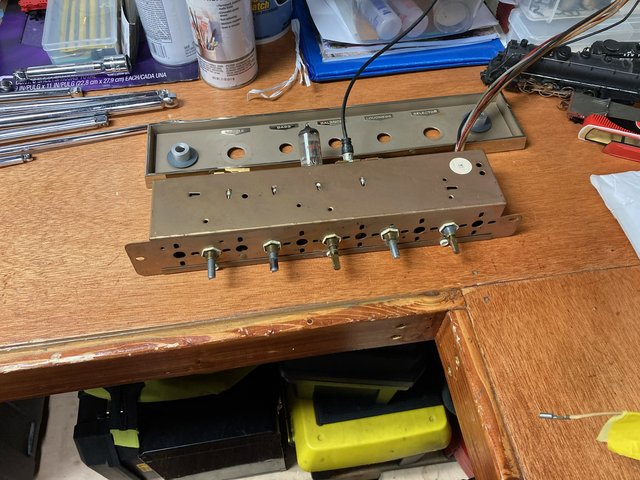

Thanks, Cademan. Here are some pictures of the tuner. There is the one RCA jack that is marked FM stereo, and then there is that jumper port that has the jumper installed for Mono. No other RCA jacks that I can see? (EDIT- I do get AM with how the tuner and pre-amp are connected now.)
First, here it was it looks like from the front when fully assembled (chassis is a HK-45-2): https://www.radiomuseum.org/r/motorola_hk45hk_4_ch_hs_822hs82.html?language_id=2

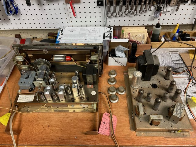

Pictures of mine...

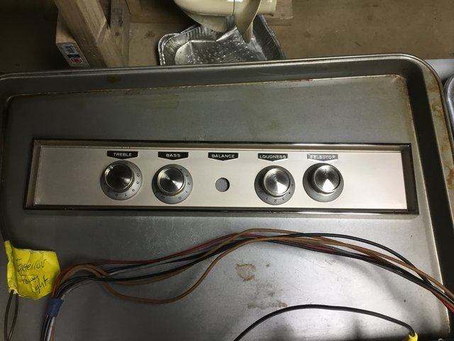

Pre-amp
