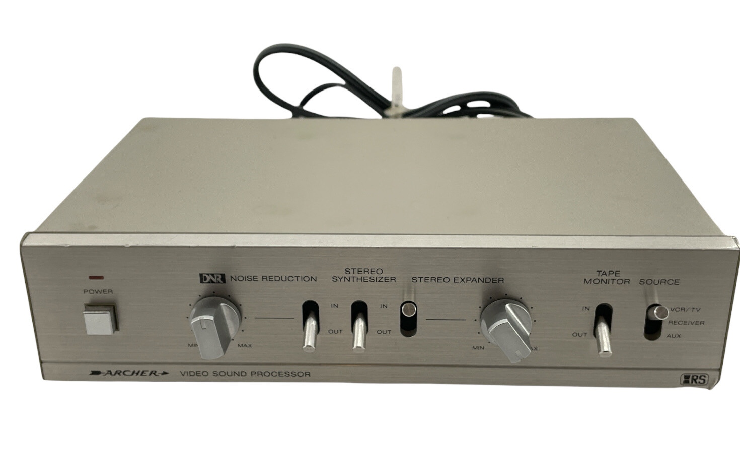

These Archer Video Sound Processors are an inexpensive way to acquire Dynamic Noise Reduction (DNR). They often show up on eBay for as low as $10.
I could not find a good demo video, but now I am looking for options that I can buy... thank you for the advice.
