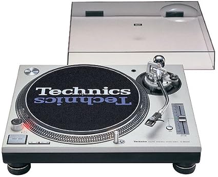

Thanks! I was just flashing on the "before" appearance:
It was my dream deck back in the 70s, before everyone told me belt drive was better, but it certainly looks a bit dated now.

PS It was going to be a bear to drop in the turntable without having an edge to hang onto, so I cheated and put the rear strip of wood on magnetic locator pins.
So I assume the plinth bottom is not open to support the tt from beneath to lower it in.
Correct; it has an 3/4" MDF "floor" that's beveled so it dropped inside flush with the bottom edge of the walnut sides. The TT is resting on that floor on Sorbathane feet.
In some sense, I guess, the original TT is thus a floating subchassis.
