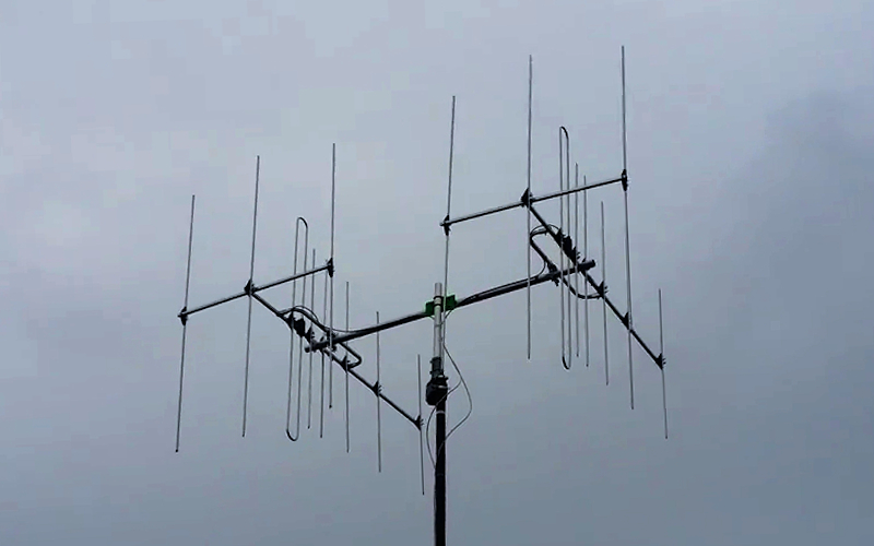

I use the commercial version of this one:
http://www.ham-radio.com/k6sti/korn92.htm
I bought it online from a German dealer at a very reasonable price. It's hooked up to a Yaesu G-450C rotator. Good for DXing, and especially fun now that the Sporadic-E season is upon us.
Regards,
Nick
