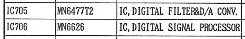

The manual says this is what my CD player has (it is made in 1991):
I could not find datasheets for these ICs, but I think there is just one of each, not four. Weird.

I was trawling through some old catalogues on hifiengine for info, but have exceeded my daily download quota of manuals/brochures.
I did find this:
