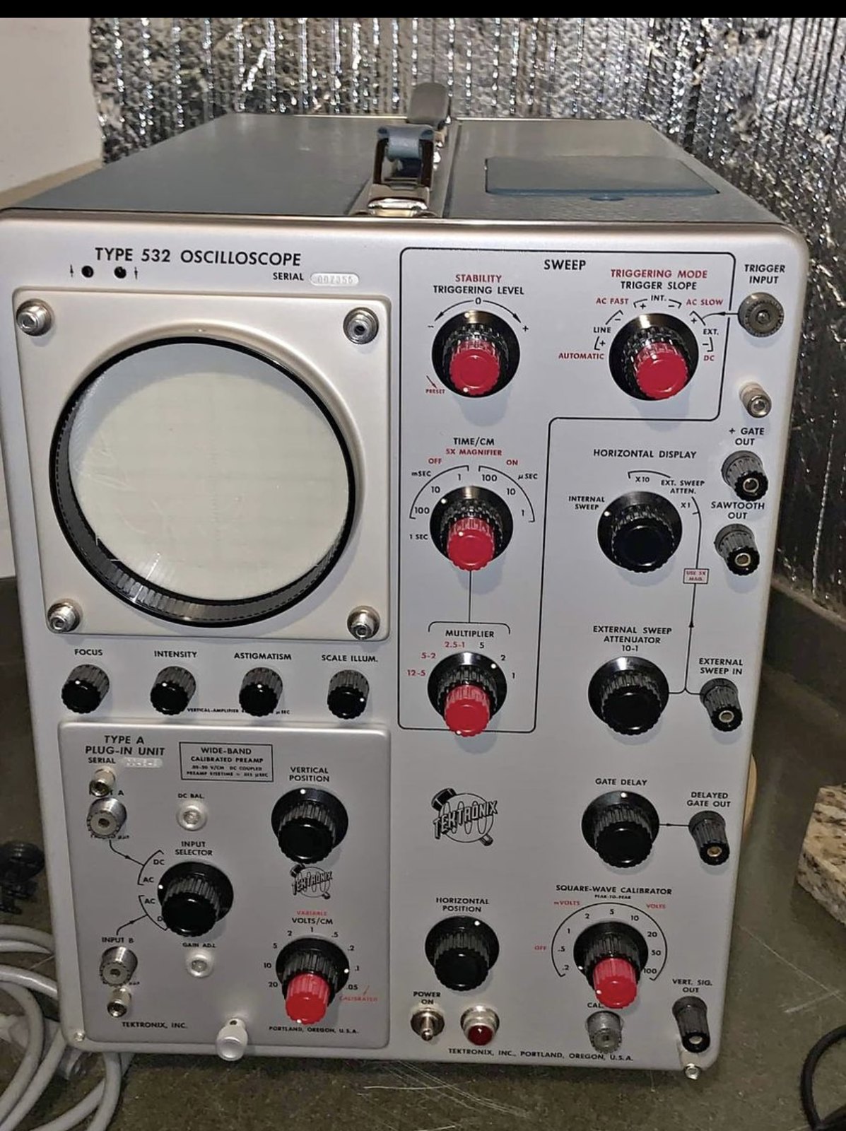

There is a NOS Type 535 I have been eying up. But shipping it would scare me.
Here are some pics of it
But room is an issue for me. I have been looking where I could add more work space for this.

It is a beauty indeed.
Worth a road trip, if that were a possibility.
Like a classic car, with all the correct numbers.
Looking at the date on the probe manual, I see May 1970 !

Shipping? It’s in Syracuse… not far lol.
I talked to the guy about it a few weeks ago. The 532 is one of only 4 devices that uses the same crt as the 570 and 575 curve tracers I have. I would love a spare. I’d want to pay him less than half of his asking though.
It’s not a very good scope otherwise, only 5 MHz
