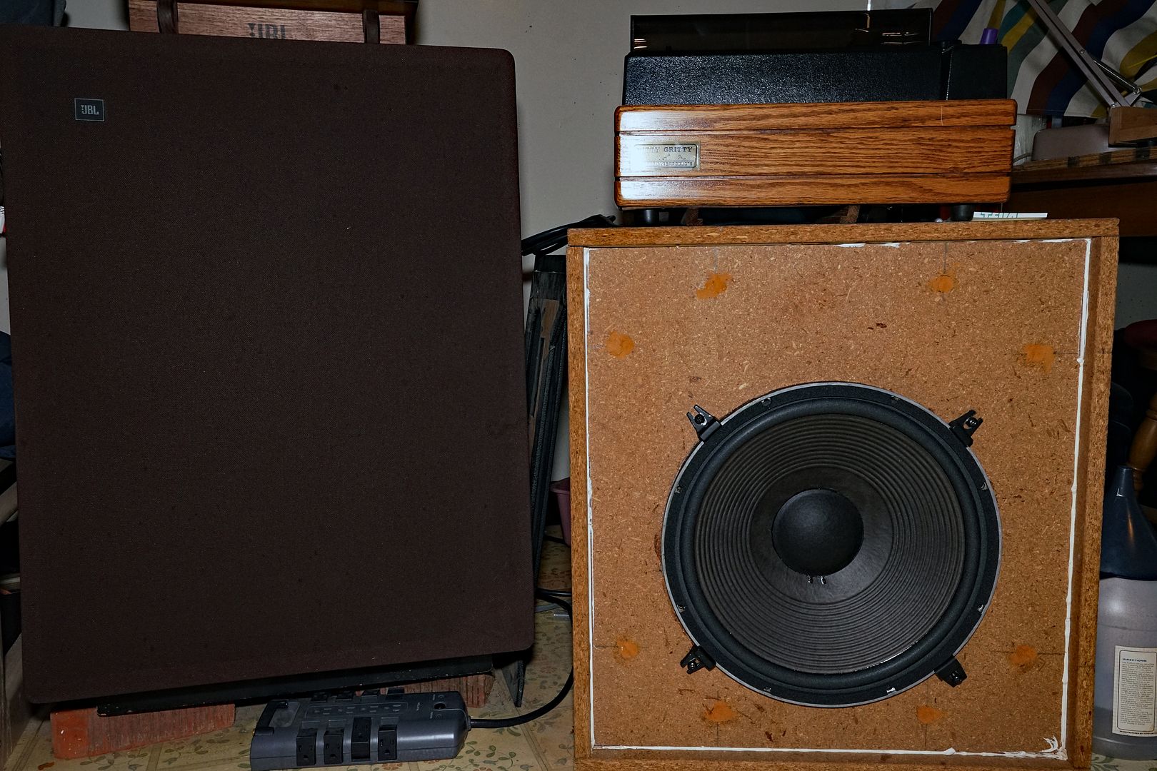

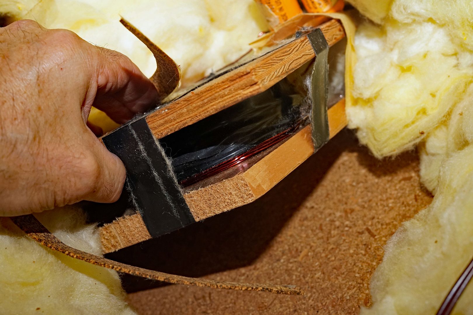

BTW... for my subwoofers, I had to wind my own air-core chokes, since 12-gauge, 20 mH ones were prohibitively expensive at the time.

They were available on the commercial market at that time. I don't remember what the application was. They were very expensive, almost mil-spec quality.
I bought 5-pound rolls of Belden enamelled single-stranded copper wire and wound them to the specs a friend calculated for me.
