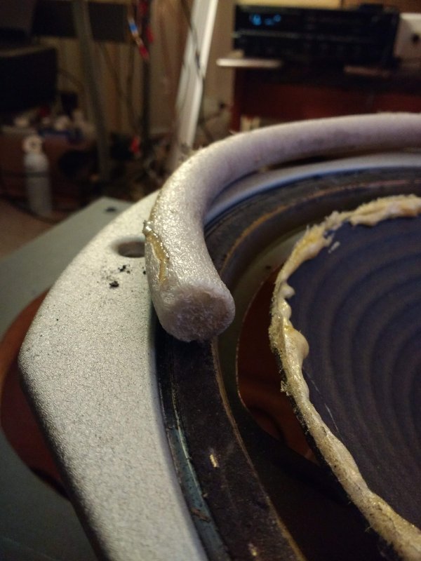

Backer rod and gorilla glue? If the glue was more flexible, maybe I could see that working. Shoe goop, maybe. Ah crap, now I'm pondering bad repairs :0

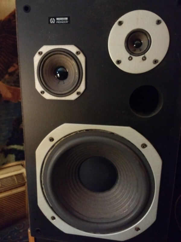

I can happily say that after some love and care, and some L-pads to balance out the crappy design, these things sing just as good as my HPM 100's.....

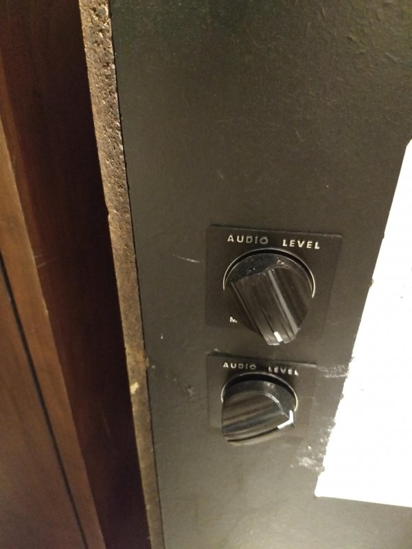

Same cab, 3/4 inch and 1 inch front baffle, just stamped steel drivers but same coil sizes.... I added the L-pads on back, one for high and one for mids.
