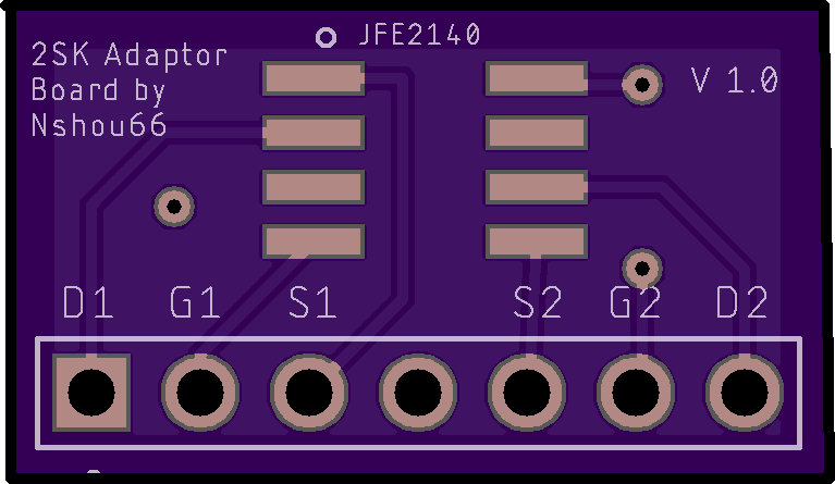

Well I decided too make a board or attempt to . It should fit in the A-1 Driver board and two back to
back will also fit. I need too add a coper plane to the back side still. May work we'll with out it just thinking of noise reduction with it.
The chip data is here JFE2140 The experts here would need to chime in if it will or if another dual Jfet
SOIC 8 chip would be better.
Here is the board layout 17mm wide by 11 mm high.
Athanasios
Well I made the adapter board for the JFE 2140 . Still need to test it in circuit. Might be next week or the week after.
Here are the pics and the test from my DCA pro75

A beautiful set of images, very neat work!
So the individual elements are:
Custom pcb,
JFE2140,
and the pins (7 individual ones per board or are they already linked and one just breaks off a set of 7?)
Hope that it performs well once it’s in circuit.

I could not adjust idle current voltages along with the DC offset on that channel. And I remember that I had the same issue with my JDM A1 a few months back and it was the dirty legs of the 2SK 100 . SO I inspected the chip closely and found that the trace to one of the gate pins was gone , severed !! It must have happened while desoldering the chip from the onset. I must have not noticed it when I soldered int he JFE 2140 board.
Here is the pic, dont mind the crappy solder job it was just to put it back together quickly as not to loose the chip.
So I made a jumper and fired it up and the relays clicked on!!! YES !!!
Next I removed the Sk100 and installed the JFE 2140 and fired it up and hooked up the DMM to the DC offset test point to see what was amiss.
No Relay click !! CRAP!!! HOWEVER I noticed the DC offset was not at 50+ but at about 3.5 vdc, SO I adjusted the trimpot hoping I would have enough range and the relay clicked on!!!! I was able to get it to the 10 mv and hooked up my function generator and fed it a 1khz sine wave at 100mv and turned up the volume to see if the scope showed the wave , and there it was in all its glory!!! Listened with head phones and I never was so happy to hear that annoying 1khz tone , I cranked it !!! lol
Jumper for Gate pin .
And the 1kHz sine waves.
The pins on the adaptor board a little larger than the existing holes and need to be drilled out.
Not sure why Yamaha put the chips on the vertical board but I may try to just remove that board and instal the assembly right to the main board. If its an issue I can alway make a taller board to bring the chips up off the main board like Yammys board. Shouldn't cost more.

Just played about 45 minutes of music with volume quite loud at about 3 O'Clock !!!! Heat sinks just got a little warm and sound was crisp and clear. Now this is an unmolested unit with no re cap or anything done to it besides using the JFE-2140 on the adaptor board.
As stated earlier the holes need to be drilled out on the Yamaha fet mounting board. I used a 1 mm drill
bit as measured with a caliper . Drill from the solder pad side . The traces are delicate so be slow and careful .
I still want to try these mounted directly to the main drive PCB removing the daughter board NA07046.
