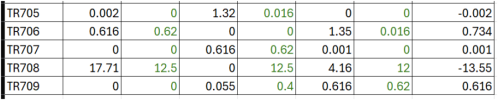

Need a better understanding of the protect circuit
Note the following,
- TR708 is for relay drive, need e-b current flow for relay to kick in
- TR709 is for control. It takes the results of the sensing transistors and sets/resets the relay drive TR. It also acts on the power on/off mute.
-TR705 and TR707 are for sensing (fault)
- L&R OUT pins connect to TR705e and TR707b (via some resistors)
- if the offset is more than -400mV to -500mV then TR705 turns on.
- if offset is more than +400mV to +500mV then TR707 turns on
- when either of these TR's turn on there is additional current flow from TR709b to TR707c/TR706e. This additional current flow lowers the voltage at TR709b to the point where it turns off, removing the current path for TR708e-b-... so it shuts down releasing the relay.
Your voltage measurements show an offset at about 15mV, insufficient to turn on sensing TR705,7.
TR709b (control) at 600mV should be ok, almost border line low, it's set by R716 and D710Vf.
So far everything looks ok.
TR708e supply comes from halfwave rectified via D707, 14.6V is expected since no current flow/volt drop. It is actually 17.71 no voltage drop across R714
TR708b should be about 12V when current flowing and about 12.6V when no/little(leakage) current flow. It is actually 4.16
You have 1.14V makes me think TR708e-b has failed near open, diode check. Other alternative is TR709c-e open but would expect about 12V at collector in this case.
Earlier today the relay would react to the DMM probe touching TR709 c or e. it has now stopped doing that.
what is voltage on either side of R711( 10kohm) ? Want to see if voltage is on the outputs L and R .
