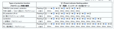

I don't think the unit protection is a result of something connected to the unit. More than likely it is a failure in one of the output channels.
The unit is not user serviceable due to the extreme use of SMD components. Yamaha Service will not troubleshoot to component level and simply does board swapping.
Are you able to read and understand that blinking light failure code? Good Luck! :mad:

Protection indicated by flashing power indication lamp,
Hopefully "PS Protection" as it can be the easiest to repair, seen a few RX-V's with failed voltage regulators and caps that prop up these rails.
Can someone please help me with the service manual. Hifiengine won't allow any new users accounts in their system unfortunately. My unit flashes for 3 times when I turn it on and switches it self off. I have tried pressing the SW85 switch to reset and it is still the same result. It won't reset the CPU. Greatly appreciate your help.

Over Power Protection: Thermal Overload or Power Supply issue
I am happy to post that I followed the instruction to reset the CPU, now I have full sound. One item still an issue is the cooling fans are not running. Therefore that error code in memory of THM/OLV protection detected excessive heat in the output.
How did you reset CPU? I have same issue THM/OLV error.
Just in case anyone else comes across this thread looking for how to reset the unit, I've found holding the reset button and plugging the power in does seem to reset the unit. Obviously whatever caused the issue is likely still present, in my case it might work for a few days before whatever the issue is manifests and the amp dies again.... :/
