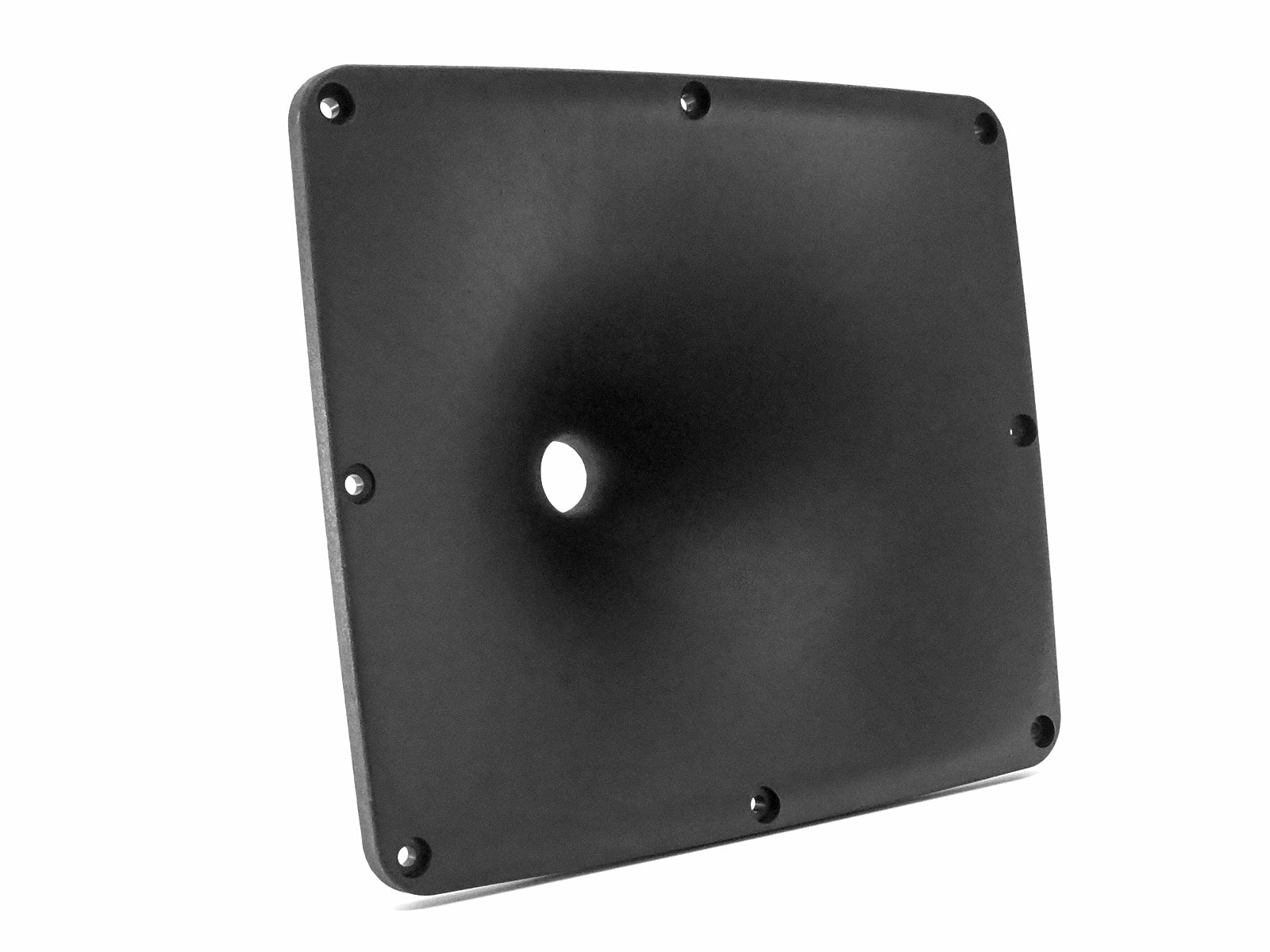

Anyone have opinions on the SEOS-15 guide? They claim that it will reach 950 Hz but from the
front it looks smallish for a 15" and it is not very deep.
How does it sound?

The SEOS 15 is back and I've been wondering about the performance and just stumbled
onto this review by Erin of the HTM 12V2 which was a DIY Sound Group design that uses
a Celestion CDX1-1742 ($100 special order) driver on the SEOS 15 WG:

calbuilder that PRV horn that you mentioned will not work since it is not constant directivity.
I'm thinking that if a builder just wants a smaller horn the Eminence WG-10 might work
without having to make major changes to the crossover. We want a constant directivity
or PT waveguide and not some other taper:
Or maybe the SEOS 10 or XT1086.
The XT1086 would be my first choice.
I've been meaning to point out here that it seems as if JBL has moved toward 100x90 deg waveguide
patterns for home and studio applications. The vertical pattern of the JBL 6x12 might be a bit tight
in the vertical to cover both seated and standing listening. Based on this thinking the OS11B might
be a better choice it is 11.25" wide, not sure if that fits the bullnose NLA, also the height (9.75") might
be tight in the NLA because the woofer is mounted higher up, should work fine in the OLA:
Pete, thanks very much for all the help. I will default to the H6512 if I can't find a suitable alternative. The bullnose NLA measures 7" from top to edge of woofer basket and 11.3" across. Really limits options. The WG-10 and XT1086 are too big for that and I don't think they could be trimmed to fit. The SEOS 10 or the SEOS 838, a tweeter mount version of the SEOS 10 will fit. A this point I am not sure if the consensus is compression drivers are the way to go. I watched a video comparing compression drivers to tweeters in waveguides by ASR. His measurements showed compression drivers were more efficient and performed slightly better, especially at low frequencies. Also, Some of the smaller Denovo Oblate Spheroids would also work but not the OS-11B.
Yes it seems like cutting down the H6512 is the simplest thing to do. You can measure but
