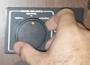

What did you have to do to get the crossovers out?
From memory
Remove knob then carefully remove plate to reveal wood screws. Unscrew
