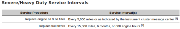

IMO it is best to use the manufactures "Severe Use" maintenance schedule, which if you read it thoroughly it is the way most people drive- for our Dodge Chargers the severe schedule says 3K oil changes and 60,000 mile trans fluid change. The 10 yr anti freeze goes down to 6 years.
I like this idea. Found this for the Powerstroke 6.7. I would reduce the fuel filter interval to 10K personally.
