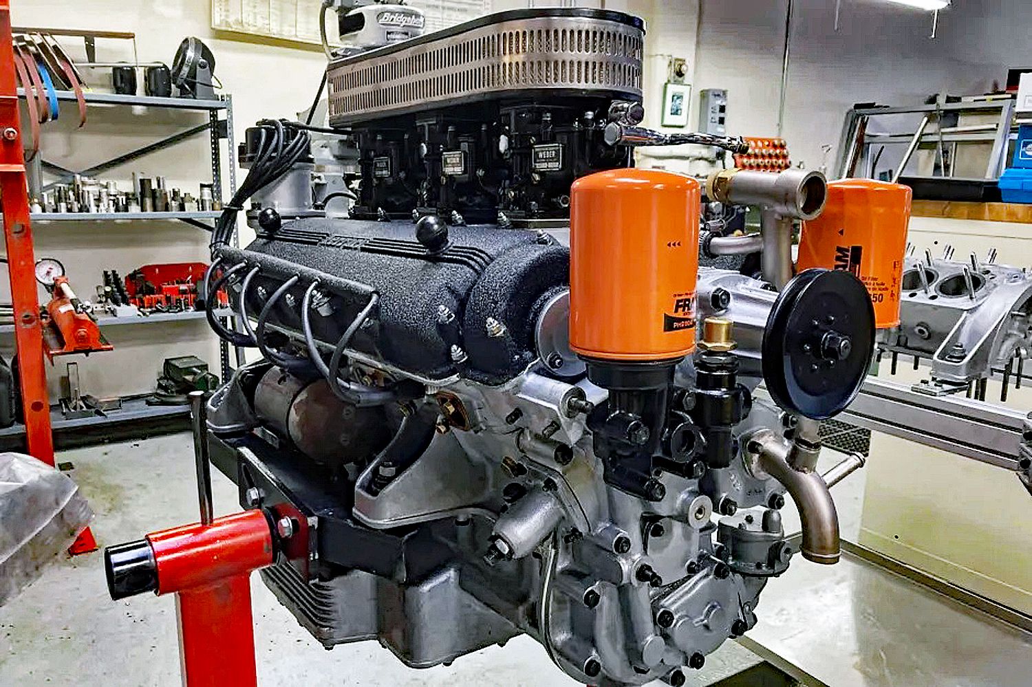

At one time, they were the US OEM oil filter maker for Ferrari. Those days are long gone.
1962 Ferrari Tipo 128 V-12 engine.
Yup, Baldwin or UFI's are the filters to use with Ferrari. Baldwin having the aesthetic advantage for a Ferrari of being red. Chinetti co-branded Baldwin filters back in the day (pic below) for their dealership and NART racing team.
The other thing, largely unique to Ferrari (all models up until the 430), is the need for an internal standpipe built into the oil filter because the filters are mounted upside down. Without the standpipe, the oil drains out of the filter every time you shut off the engine -- so the engine starves briefly for oil, at the time oil flow is most critical, each restart the engine until the oil filter refills with oil. Since the vast, vast majority of cars don't need a standpipe, there are oil filter brands and models that are listed as "fitting" a Ferrari, which they do physically, but that don't have a standpipe and actually will significantly accelerate engine wear over time (delay in oil flow each restart).
