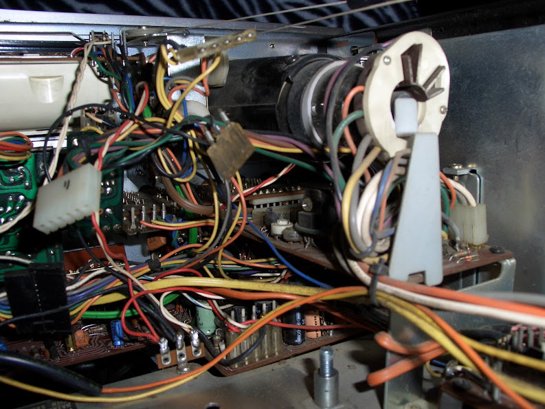

A few more photos from a unique angle. I had to pulled the tranny sub chassis to replace the filter caps.

Well I dug in a bit tonight, starting with the chassis. I separated the clutter, remove the scope and cleaned things up. The only good thing about this thing being in pieces is the easy access. I prepped the new filter board, which has to be modified, and replaced the bypass caps on the rectifiers. I will be cleaning and repairing boards next.
From the boards in front of the tuner, under the scope.
There are some I couldn't get a good shot. Its nasty in that area. Real cluster of wires.

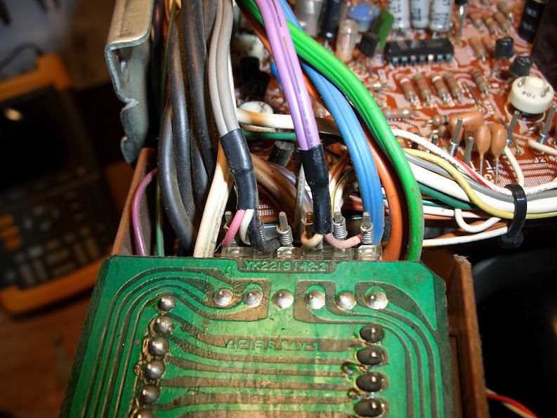

Finished cleaning and fixing the detachable boards. I found plenty of signs of repair work too....
This isn't good. Whatever was used to break the traces just spread copper around. There was still continuity between those wires.
Here is the after shot. I just built a solder trace then covered it with epoxy.
