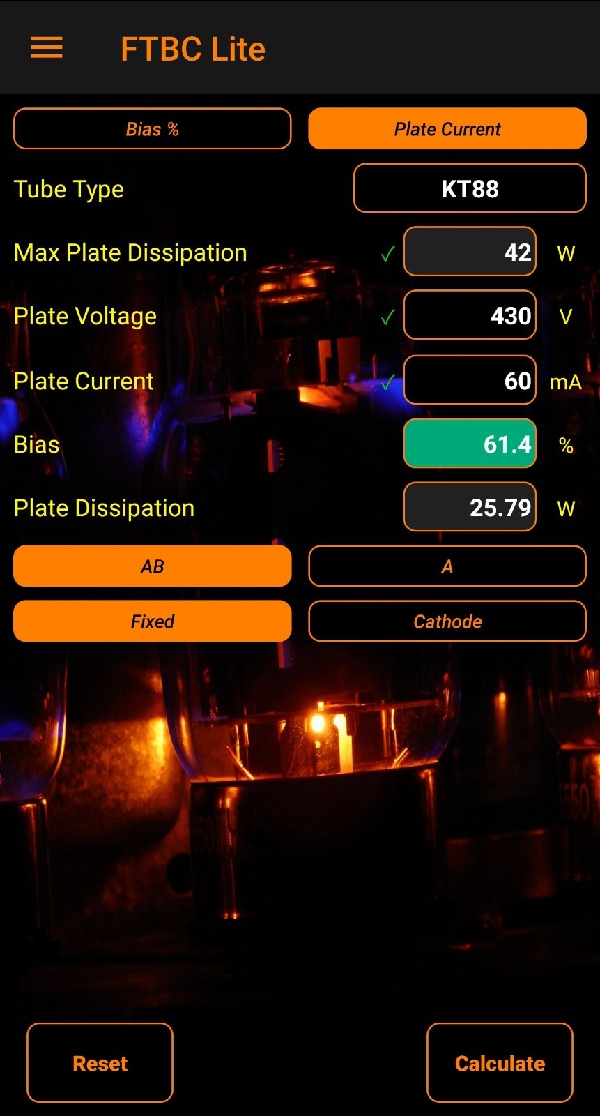

since the audion mentions class-a operation chances are the output tube bias is going to be a little bit unhealthy, and no pots to adjust (fixed bias). time to do some resistor hunting and bias calculations.
