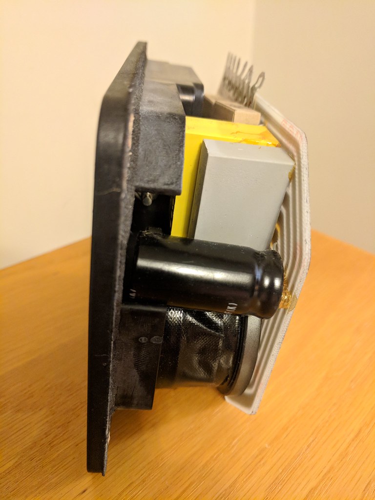

Another update. I pulled one of the crossovers out and I can only see one electrolytic cap. This seems to be par for the course with other ADS crossovers I've seen. Minimal use of electrolytics and, as @GD70 said, film caps used elsewhere. When I get some free time, I'll pull it and check it with my MM, but I might as well replace it while it's out. With consideration given to the substantial cost of other aspects of this restoration, I plan on leaving the film caps and other components of the crossovers as they are.
It blows my mind how ADS manages to keep their crossovers so compact considering the amount of drivers used. Looking at the speakers, you'd never guess that the entire crossover would fit on a board the size of the terminal plate. Unreal. Compared to the crossover network in my Legacy Classics, this is a welcome sight!

Also, even though your 2030's use mainly film capacitors, film caps can degrade too. Specifically, even film caps have a finite lifespan, that can be considerably shortened, if the caps are exposed to high heat, constant high power or both. So, you may want to consider an eventual recap, if suitable caps can be found?
Yes, understood regarding the film caps. Eventually I will re-visit the crossovers and recap, just not yet. Unless I find something wrong with them that needs addressed immediately. The switch panels will be getting priority as one of them is acting up.
