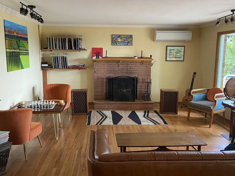

As a happy side note, finally got the speakers in the right place, I can tell because my dog stares at the fireplace when she likes the singer.
