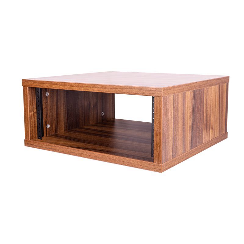

Something like a 4u rack unit could house the gear you need and probably wouldn't take up excessive room on your work surface.
